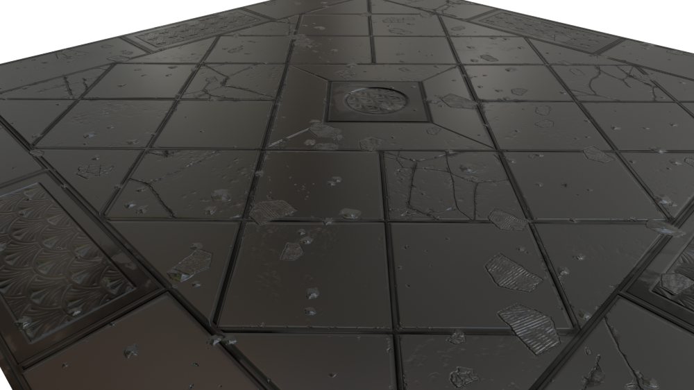

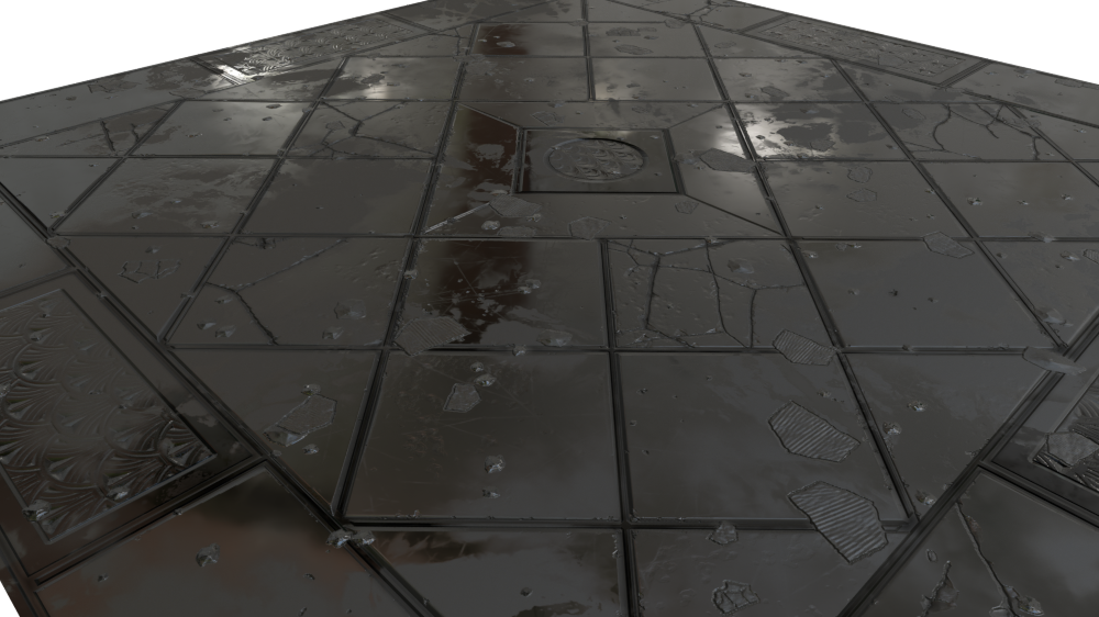

Modo's render looks correct:

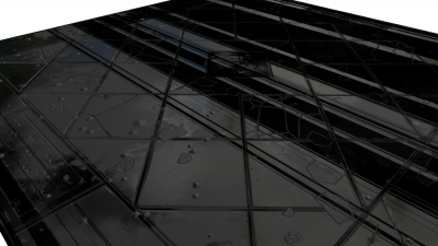

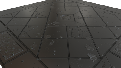

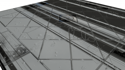

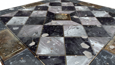

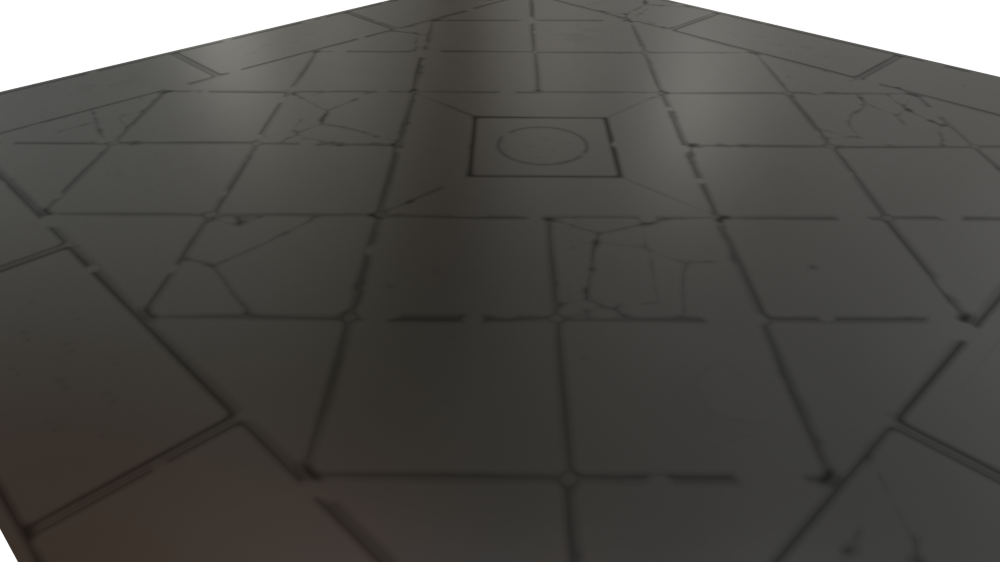

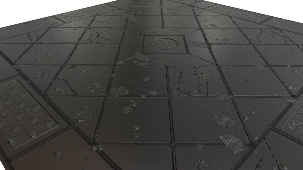

The octane render looks ok until the normal and basecolour outputs are added. I've added the outputs one at a time:
AO
AO + Height
AO + Height + Spec / Metal
AO + Height + Spec / Metal + Rough
AO + Height + Spec / Metal + Rough + Normal
AO + Height + Spec / Metal + Rough + Normal + Basecolour
The Normal and Basecolour outputs aren't mapping correctly. I've had the same issue with most of the materials from SubstanceShare, although a couple look fine.

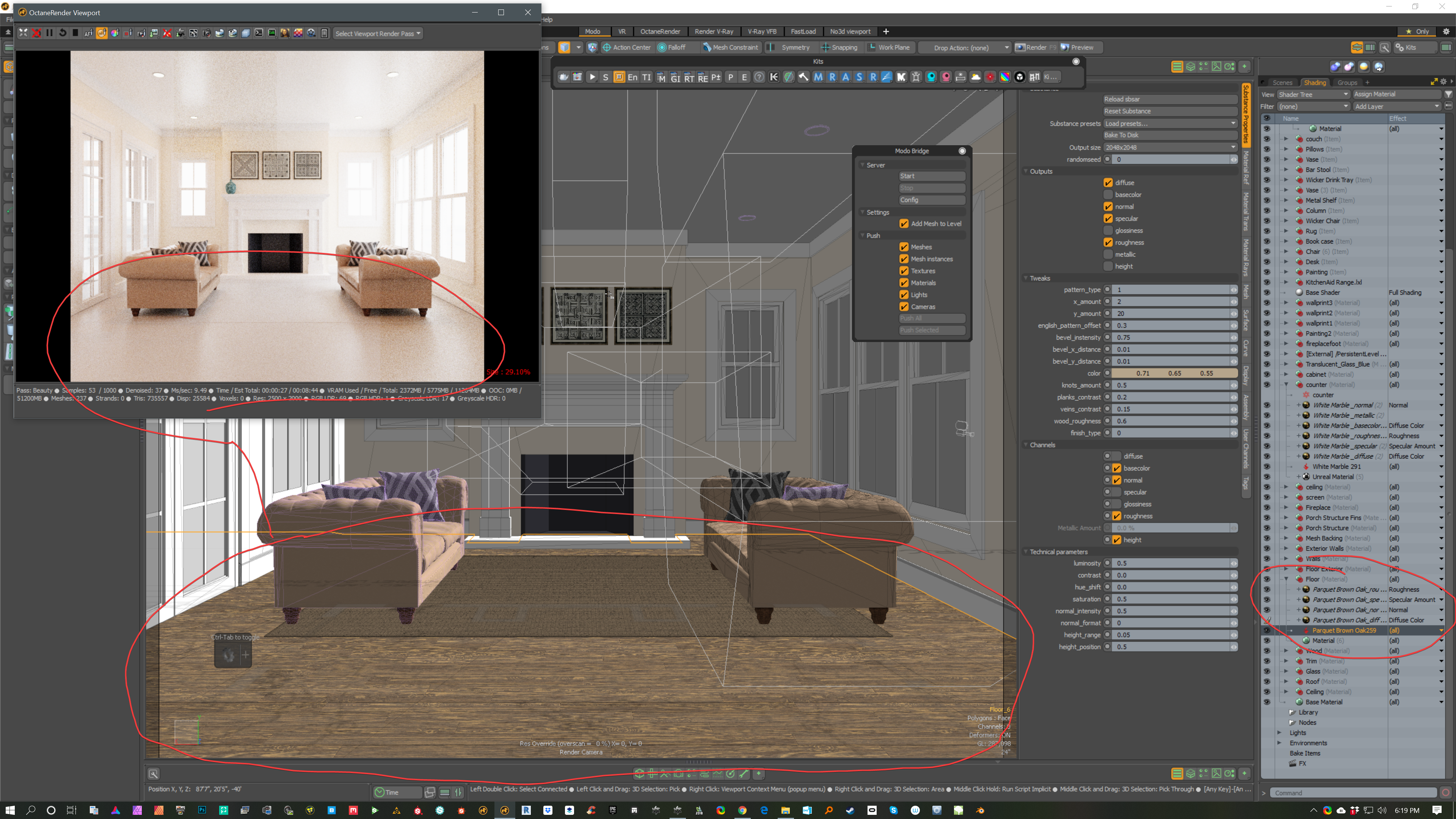

Glad I finally decided to search for this.. My normal maps aren't working. Same setup, Modo 12 Substance 2019.1.2
Also, when I use the substance plugin, I create the substance, then thats pretty much all the plugin does. I don't get anymore options anywhere else.
