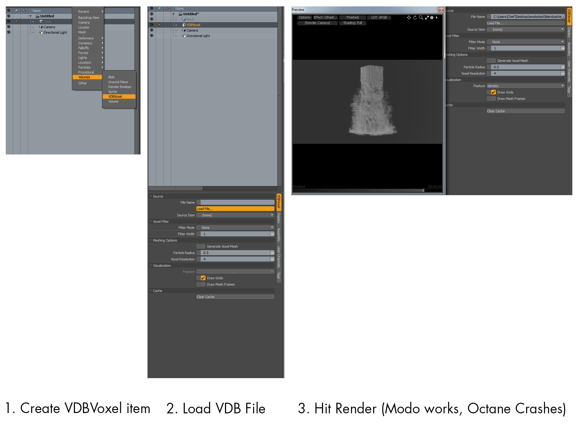

if i load a openvdb file via the openvdbvoxelitem and hit render Modo crashes instantly. The vdb File is generated from Blender and loads both in the Standalone and the Modorenderer just fine. Is there a solution to this?

Hi - how exactly are you loading the vbd pls? Can you post a screenshot of how you did this? Are you able to also post the vdb pls?

Hey Paul, sure:

I have found the issue - and it will be fixed in the next release. In the meantime, pls do not attempt to render vdb files in the plugin.if i load a openvdb file via the openvdbvoxelitem and hit render Modo crashes instantly. The vdb File is generated from Blender and loads both in the Standalone and the Modorenderer just fine. Is there a solution to this?
