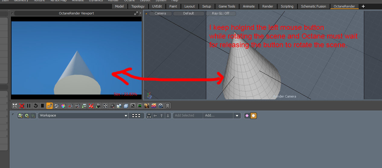

Update on mouse button release unticked does not update on the fly the viewport.

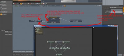

Another thing with node graphs - is there any chance to add plugin inputs from standalone node graphs in modo automatically? Please take a look at the screenshot.
It might take a Refresh in order for this setting to take effect. What specifically is not updating on the fly?
This is a good suggestion - but something I would prefer to put on hold for the moment. It's possible the Open Shader Language implementation may change how the NodeGraph is implemented in the plugin.

I meant the the viewport is not updating while changing a scene but only when I release a mouse button. See the screenshot. (PS sorry for error 'keep holding' not 'holgind'.)
Yes, regretfully whilst holding the mouse button down to move the camera, Modo withholds all updates until you release the mouse button. Yes can see this if you look at the camera transform in Modo - it is only updated when you release the mouse button. So this is a limitation of Modo.

Thanks Paul.
I just thought that the 'update on mouse button release' is responsible for that. Anyway thank you so much for your fantastic work and awesome plugin. I am slowly getting used to it moving from the Standalone.
