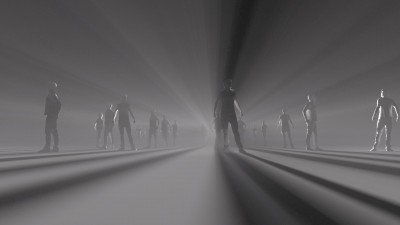

Hi, thanks for the build! I've been trying to get the light beams in post processing working but I can't get them to work. Could you provide a working example?
edit:
I made it work.

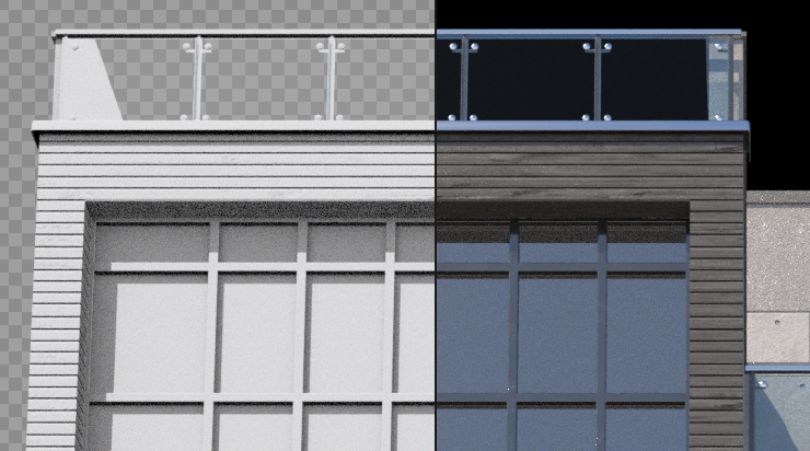

Transparent ( high thin wall transmission ) materials like glass have visible shadows in AOV shadow pass :
even with disabled shadow visibility in object tag. Only way to get rid of the shadows in shadow pass is to disable "S"un in object light pass mask

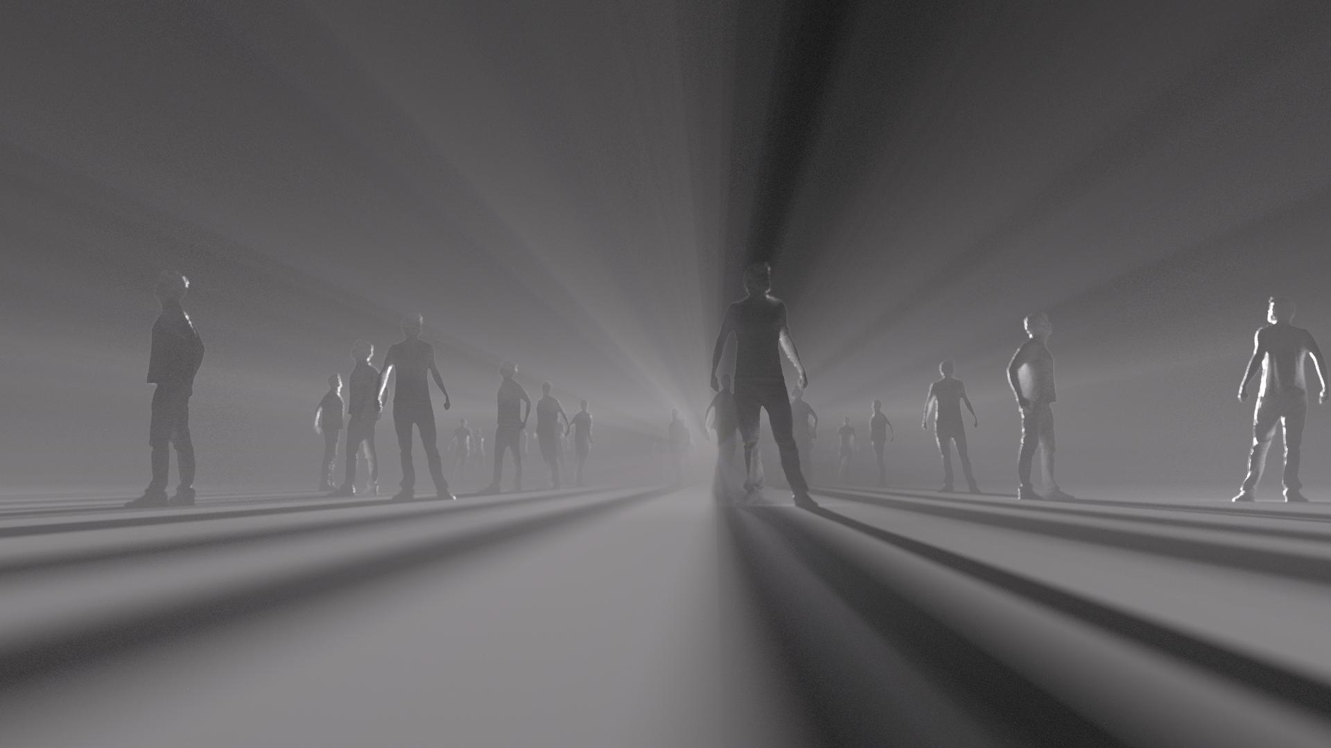

elsksa wrote:
J.C wrote: edit:
I made it work.
Could you share how?
I've done all the correct steps and can't get it. Enabled the relevant options, light is rather small, nothing. I'd be surprised if I missed a step somewhere as I triple checked it all.
Use directional or sun light. Enable "Use in post volume" in light properties. Turn on light beams effect in Post processing volume settings.

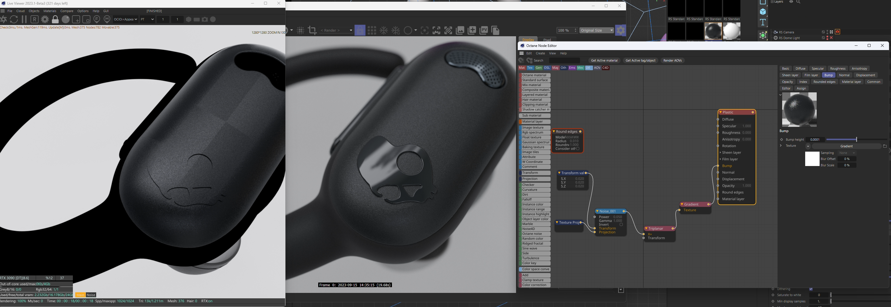

Seems like bump mapping in Octane is having some issues.
Beta 2 seems to work better.
Here is a example between redshift and octane with a noise bump ran through a triplanar (seems to cause the issue).
Redshift maintains bump detail far far better even at a very small scale.
Octane falls apart and creates weird shading artifacts and loses bump details.
As per usual scaling the scene up from its real world size to the size of a truck seems to work. Except for the fact you break everything else material wise and asset wise thats all based on real world scales.
Please look into this, it seems to be a re-occurring issue within octane.

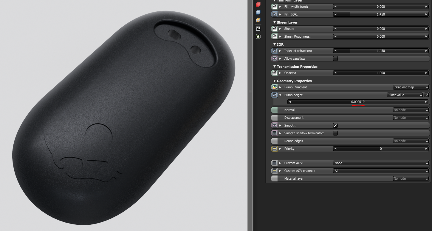

sethRichardson I replied to your PM, but will also add the info here.
I had a quick look at your file and noticed your "Noise_001" texture power is set to 0.100.
If you set this to 1.0 (10 times higher), then reduce your bump height by 10x (0.000010), the artifacts will go away.
For best results with the new bump height method, you need to leave your input textures at 1.0, then use the bump height pin to control the height instead.
Let me know if this works for you.
