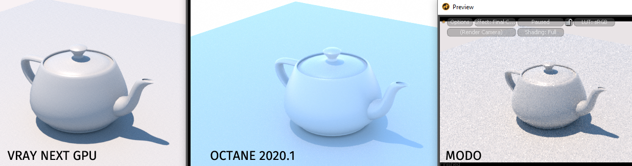

I was just talking to someone who was doing tests baking a sun/sky texture out of V-Ray. I decided to try the textures in Modo and Octane and seem to have run into an Octane bug.
The sun in the texture is extremely bright (photoshop shows values around 2.5 million), and Octane isn't rendering it correctly. I even manually set the texture import type setting to 32-bit. The render is completely different to V-Ray and Modo using the same texture.
If I take the texture into photoshop, turn the exposure down -5 (using exposure adjustment layer), then resave it, I can get a similar result in Octane, but I shouldnt have to do this.

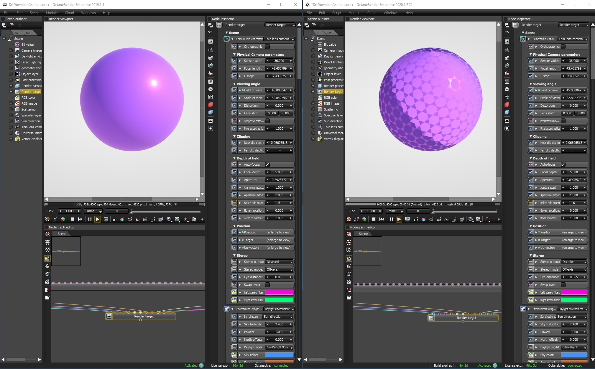

But from what i see my "sphere.orbx" report in 2020.XB3 is still broken in this 2020.1 RC1 although it's been reported as fixed.
Check these screengrabs, LEFT is correct 2019.1.5 and RIGHT is 2020.1 RC1 render = BAD.
In XB3 it was completely black so this is and upgrade/better but still not correct.
Please fix that.

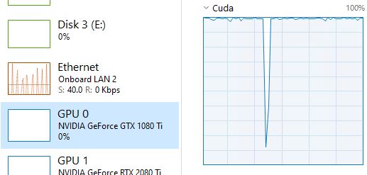

2, RTX vs network rendering
without out of core, RTX is working with network rendering:
2.1 RTX +network rendering under PMC engine
the slaves are in pretty low efficient, slave GPU usage jumping between 0 to 100% all the time
RTX network rendering2.JPG (16.19 KiB) Viewed 10611 times

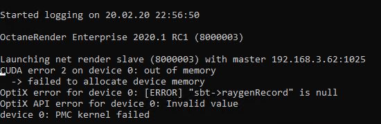

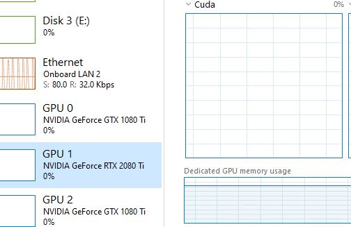

3, PMC engine vs network rendering (with occ, RTX off)
the situation is better than XB3, the network rendering works with the PMC engine now (with RTX off),
3.1 on the Slave 1 (4x1080 ti) quite perfect now (used to not working at XB3 )
3.2 on the Slave 2 (mixe GPU configuration 3x 1080ti +1x 2080ti), the 3 1080ti working fine
but the 2080 ti just report error please see below images
