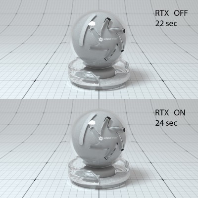

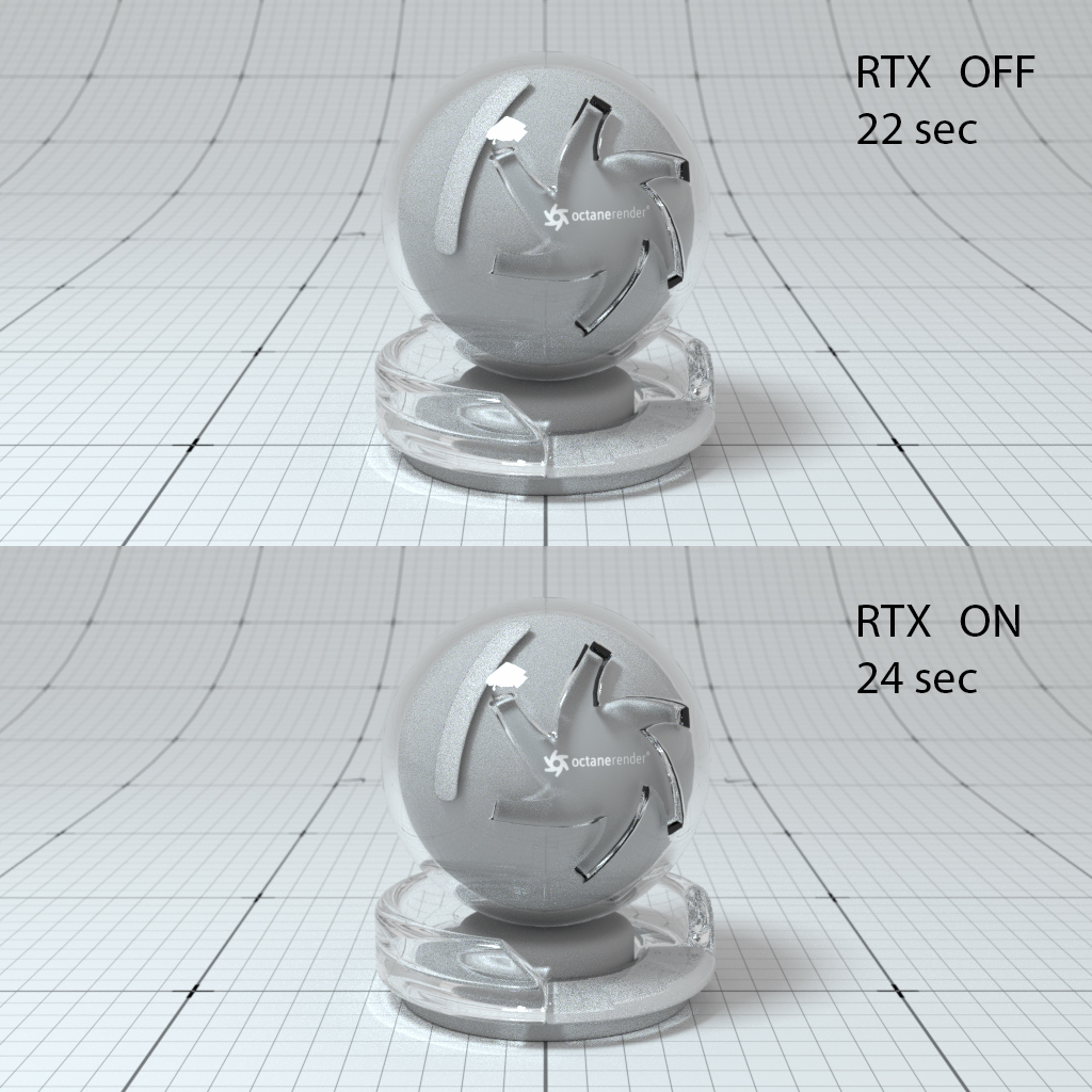

In 2019.2, we have added RTX support that speeds up raytracing. RTX on NVidia cards brings the next level of performance to Octane. We have implemented triangle mesh tracing in this experimental release, while highly scene dependent, we have witnessed render performance increase by as much as 300%.
To benchmark for scenes with RTX on mode vs RTX off mode, please refer to the benchmark and RTX preview build available at:
viewtopic.php?f=7&t=71067
viewtopic.php?f=7&t=70705
Below are example scenes with their speed improvement with RTX on mode vs RTX off mode:

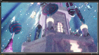

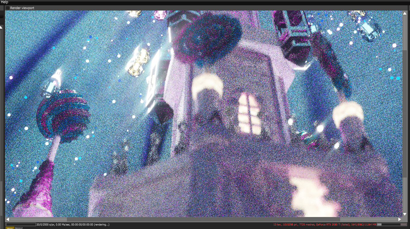

Something breaks when I turn on RTX

Emmm...
In this case I do not see the benefits of RTX. No acceleration.

From everything I've read and seen, the primary benefit of RTX is on scenes with lots of geometry. For simple scenes with complex shaders it doesn't do much.
