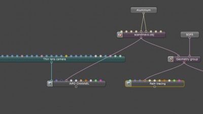

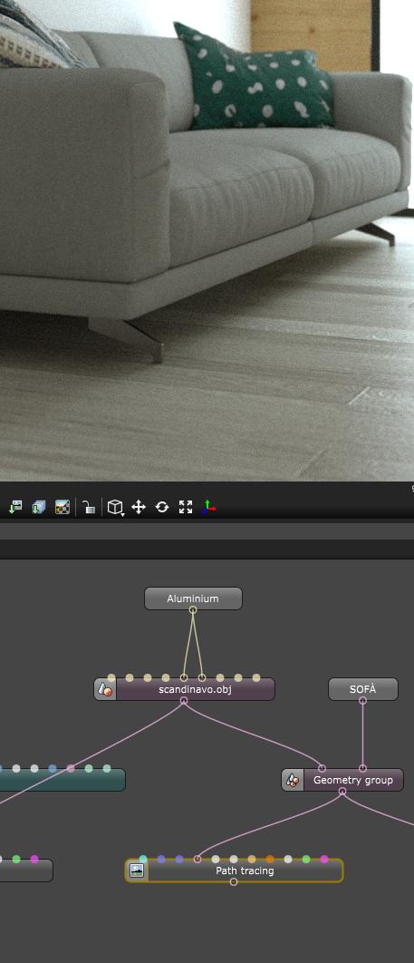

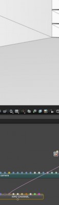

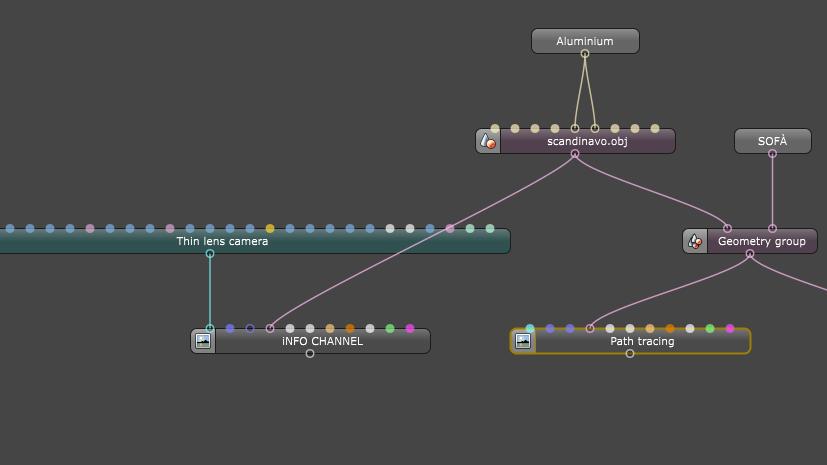

Hi guys,i have a problem with this version when I use the kernel infochannel.
When I use the infochannel kernel the sofa disappears from the scene
With other kernels it works correctly.
Path tracing
Path tracing
Info channel
Info channel

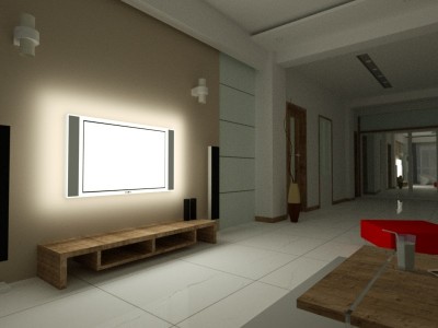

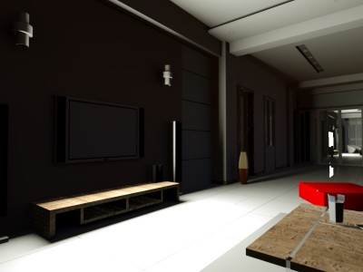

I have a scene, where I have a TV as an emitter, and emission works properly, but the 'self-brightness' of the TV itself only shows in a mirror reflection, but not in the actual 'reality'.
Is there a setting I am missing, some sort of "Show Emitter self-brightness in reflection, but not in actual scene component itself"?
(pretty sure there is...)
And, can I do this in real life? :twisted:
Thanks for any help!
Left
-TV in real,
-emitting light
-no self-brightness
Right
-TV reflection
-emitting light
-self-brightness present
And look at this, if I set the emitter as 2-sided, it works, but just the back 'glow' of the self-brightness, in both parts? :?:
Because, look how much stronger it is in the reflection, as reflection shows both forward self-brightness, and backwards self-brightness.
Also, if we could harness this power into giving free-lighting virtually, that would be awesome! :mrgreen:
Mobo: 1 Titan RTX, 1 Titan Xp
Plugs: Enterprise
Notiusweb
Posts: 1285
Okay, so if I adjust the opacity on the emission material, I can get the real foreground to match the reflection.
But any ideas how come the mirrored part won't reflect the opacity of the foreground, thx!
Ohhhhhhhhhh....
Wait - I have to uncheck "Visible on Specular" to make it appear or not appear...
:oops:
A little counter intuitive, but then again, everything is, including my perception....
our existence is counter intuitive... :geek:
How are the poor folks using Unity plugin, and the future UE4 plugin, supposed to figure this stuff out...
They are not as smart and nimble as I am, you know?
