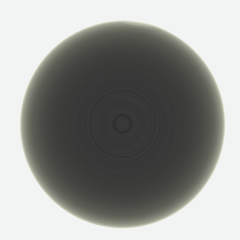

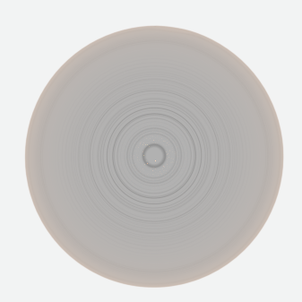

Thanks for separating sheen roughness :)
I'm noticing that you get artifacts if you have a low glossy material roughness, along with sheen/sheen roughness though.
In this example, you see a circular pattern in the glossy material
EDIT: It also appears in the metallic material
sheen_metallic_roughness_artifacts.orbx
(446.61 KiB) Downloaded 482 times
sheen_glossy_roughness_artifacts.orbx

Thanks for reporting, I'll look into it.

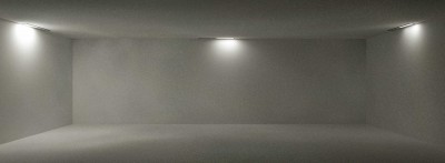

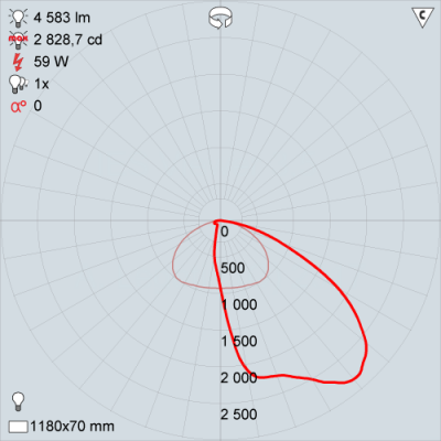

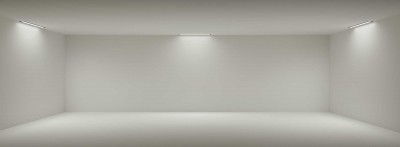

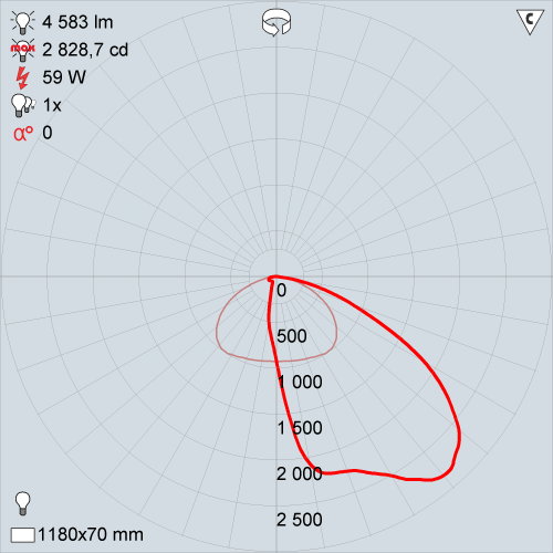

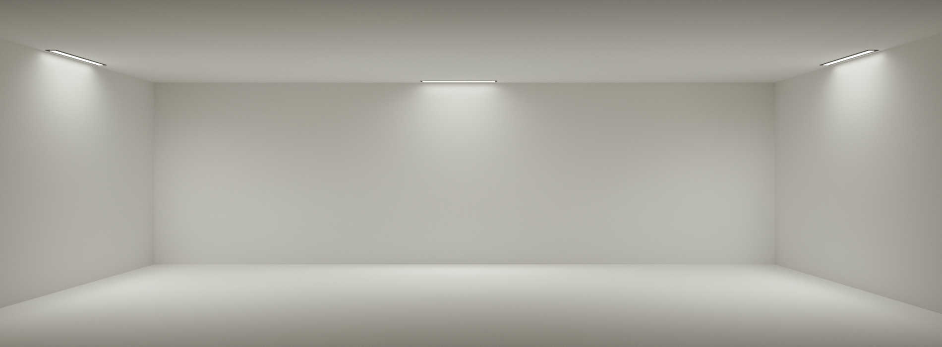

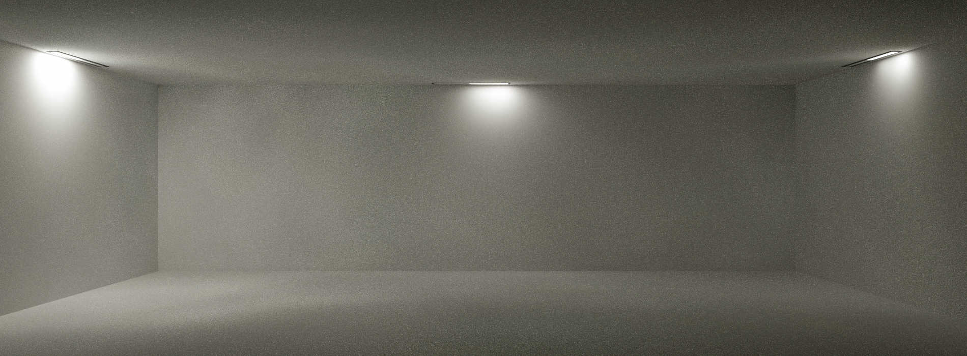

can someone 'enlighten' me, how to rotate an assymetrical ies light correctly (with 3.08)?
In 3.07 it would work with an transform node (translation 0-1) without any projection node attached.
As of 3.08 this approach doesn't work any more.
Edit: By adding a Mesh UV Projection Node the Look of 3.07 and 3.08 is the same. Still leaving the question if this is the right approach for rotating ies textures?
Thanks.
3.07
3.08
ies
Bega_Langfeldleuchten.orbx
(96.76 KiB) Downloaded 469 times

Thanks for the report. The issue should be fixed with the stable 3.08 release.
