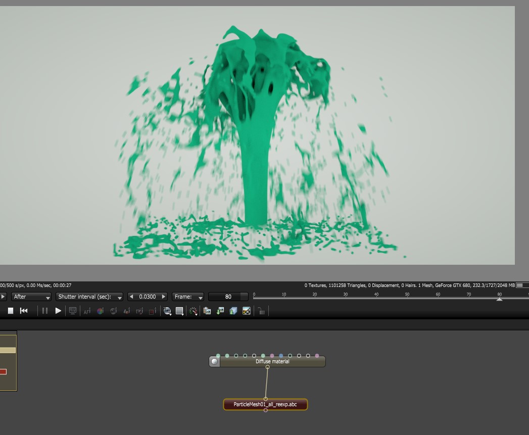

Just done a quick check of realflow meshes in Octane standalone and it all seems good,lovely mblured blobs! :)
If you are having problems just double check your alembic exporter.
quick test render of realflow+ mblur

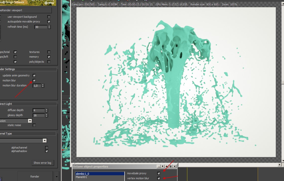

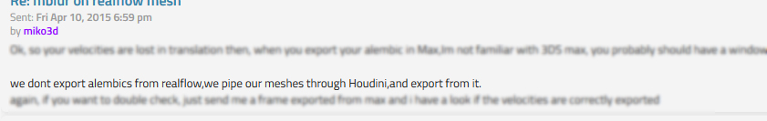

well. I was talking in PM with miko3d. it does not work with RealFlow, he works in Houdini and there is no problem with the mesh from Houdini in octane. below I have attached a picture of our conversation.. but octane has some issues with importing alembic file. in Maya and 3ds max, it opens well, octane doesn't open. also there is not any no motion blur in octane not in 3ds max via the connector. information about the velocities in alembic file is, it can be seen in the Maya attribute editor. but motion blur from RealFlow mesh no where.

figured out how to resave file to octane understood him. as I suspected there is a problem in octane with the motion blur in 3ds max. octane standalone rendered motion blur is well, octane in 3ds max, on same mesh rendered without motion blur, even though all settings turned on. here is alembic file, can see for yourself - https://www.dropbox.com/s/841ap4ezkvl1u ... r.rar?dl=0

just to be clear,
there is no problem rendering mblured geometry that changes topology per frame in Octane Standalone(like: realflow meshes) , there seem to be a problem in how realflow exports alembics that octane doesnt like as it wont import any geometry , nothing to do with mblur and it could be something as simple as fiddling with naming and export settings in realflow .
Worst case:Exporting from a third party software solves the issue.

mikinik wrote:figured out how to resave file to octane understood him. as I suspected there is a problem in octane with the motion blur in 3ds max. octane standalone rendered motion blur is well, octane in 3ds max, on same mesh rendered without motion blur, even though all settings turned on. here is alembic file, can see for yourself - https://www.dropbox.com/s/841ap4ezkvl1u ... r.rar?dl=0
it is sad that I must first himself all to understand and then prove that something is not working properly.
abstrax, can it be fixed? why I need resave alembic file to octane understood him, whereas other apps open it without problems?
When you render the Alembic file in 3ds max with some other render engine, does it render motion blur correctly?
I asked Andrey and he said that there is no vertex speed information in 3ds max meshes - at least there doesn't seem to be a way to read the vertex speeds via the 3ds max plugin API. I don't have any knowledge about the 3ds max plugin API, so I don't know if there is a way around that limitation.
