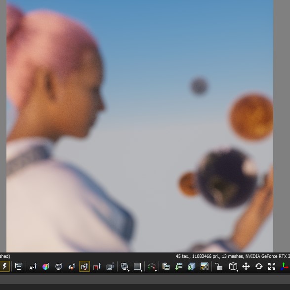

Enabling "Fog environment contribution" results in funky image.
