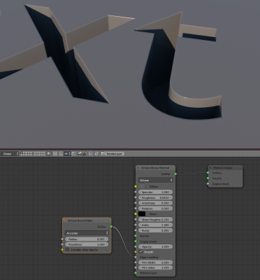

But the problem with that solution is that text edges can't be smoothed, subdivided, beveled or otherwise softened.
Alternatively you can try new rounded edges in Octane 2019.x (Blender 18.x)
I don't have this Octane All Access (I believe it's called?) -- I didn't know there were any actual Blender advantages. But this definitely looks interesting, so I'll reconsider.
