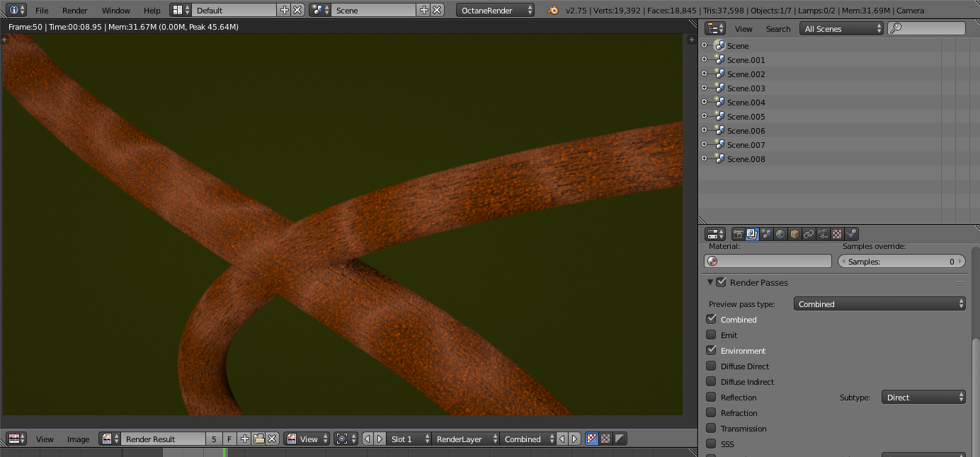

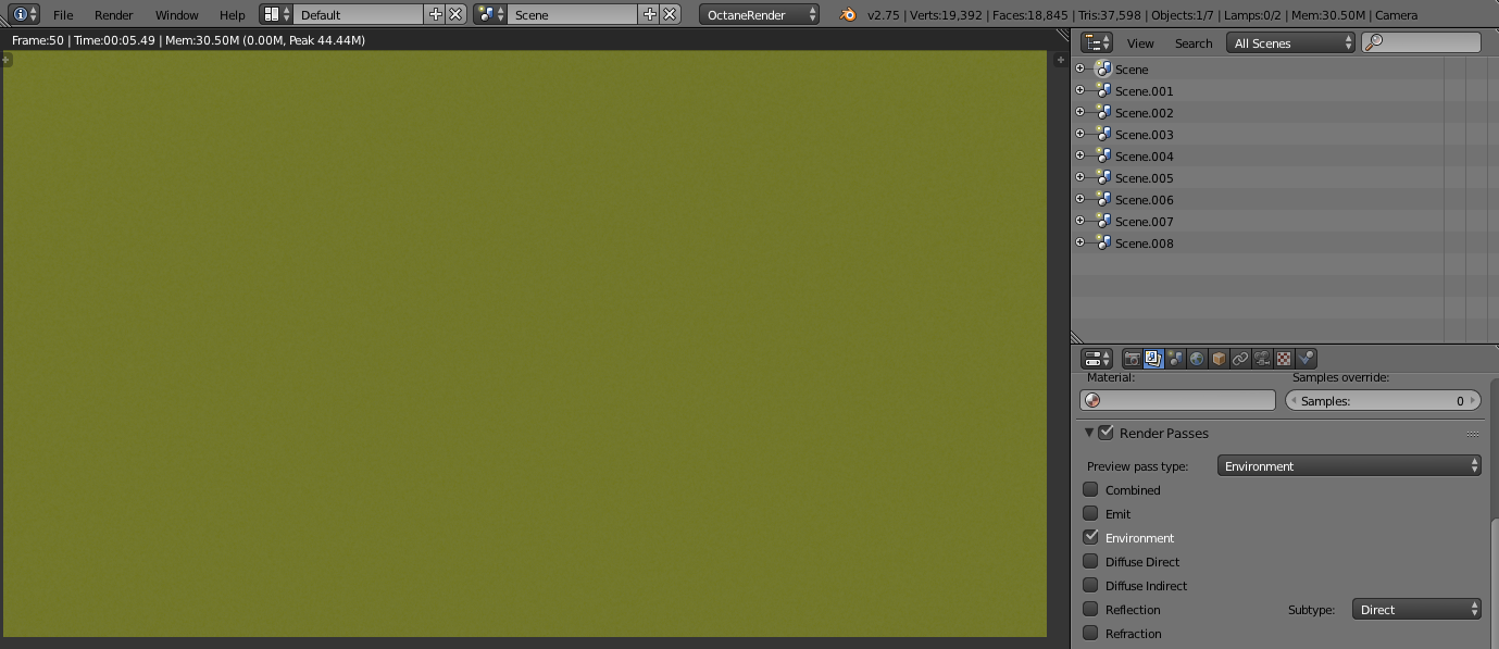

Possible bug in rendering environment passes.
Hi JimStar. I’m having an issue where my environment, when output to a separate pass, is not rendering colors correctly. While the beauty pass shows the correct environment, the solo environment pass has the wrong colors.
In live viewport rendering, though, the color looks fine when preview pass type is set to Environment. Only when an actual render pass is initiated does the environment color render wrong.
This dose not happen when the scene is exported as ORBX and rendered with layer passes in standalone.
Re: screen shots: The one with the object in it shows the correct environment background. The other screen shot shows the environment pass with the wrong colors.
Let know if you need the Blend and/or ORBX files and I will provide you a link for those.
