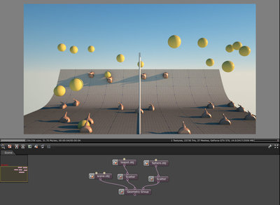

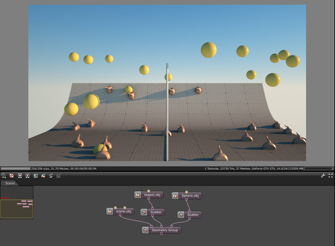

A visual reminder how to setup instances in Octane (if anoyne forgot :D )
The scene has one emitter with two PS (one hair and one emitter type). Each PS uses a different object for visualization.
Cheers!

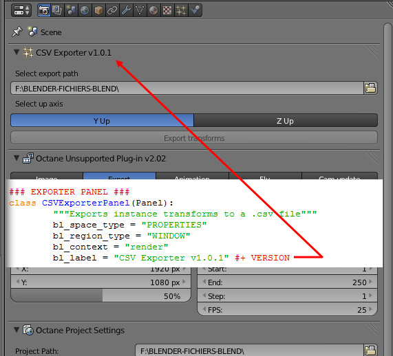

Like I did last time, I have done few cosmetical tweaks (that's all I am able to do :D ) for my own usage : Changed to the render panel to have it with my other exporters and added version number to avoid confusion if reinstall is needed.
As you may have some good reasons to disable the version number, I wrote it in the label itself.
If at one moment you have to update the script again for any reason, it could be useful to make the version number appear in the GUI :
