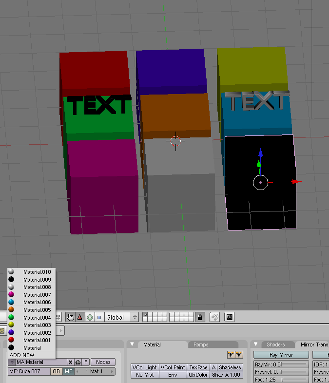

I created 9 cubes and assigned individual materials
created two pieces of text, assigned them individual materials

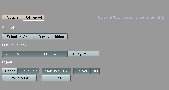

Exported with the settings shown

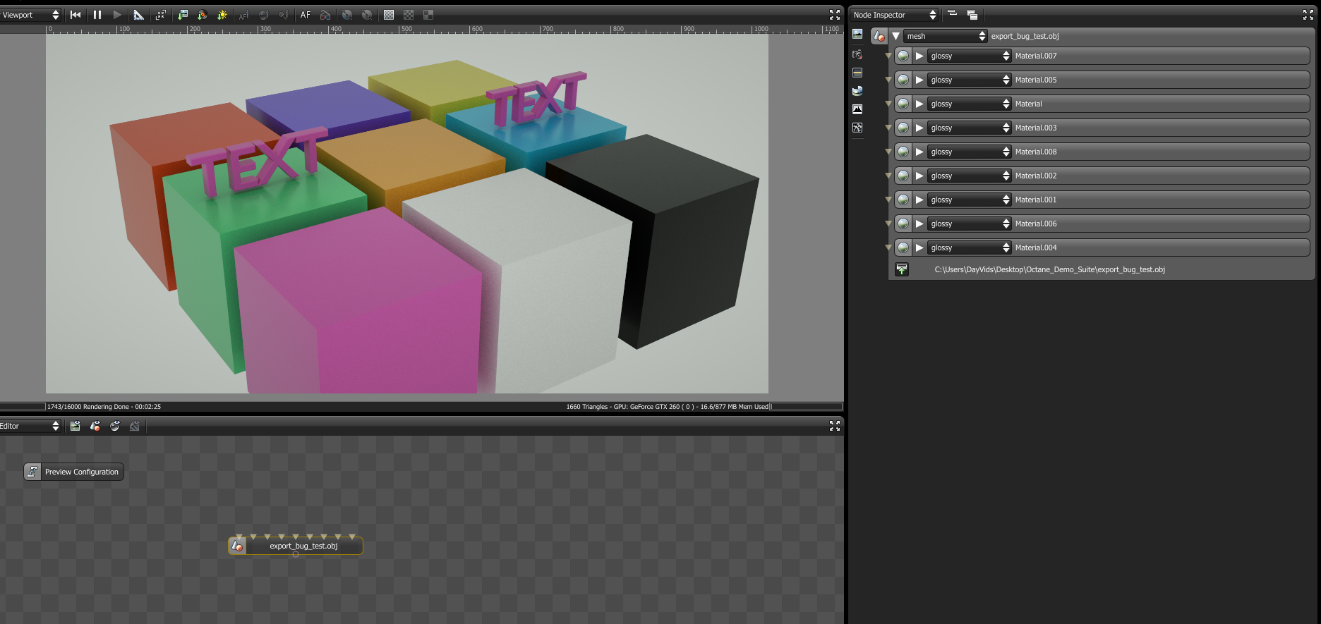

See that the materials of the text are now the material of one of the boxes, and their material's were not imported into octane.
Unless I'm doing something wrong. I have to convert everything to a mesh before I export it, because the export script or blender does not keep the materials assigned to them through the export process.
Hope this helps
How it appears in Blender and export basic export settings in Blender -> Octane Export Script.
How it imports in to Octane *note the # of materials
