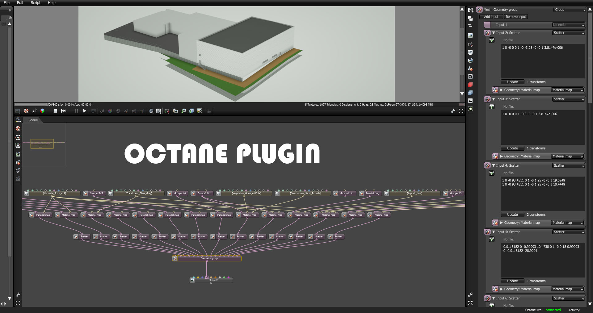

For the design of the nodegraph it is possible to add simplification options with possibility:
-to create or not the links of groups and components
-to create or not scatter links
- create only the display of the existing proxies
- to create or not layer
It requires display options, personally, I use the TIG plugin (a color sketchup = a material on Octane). I do not need groups and components.
Thank you
See as well Remark by SMICHA :viewtopic.php?f=31&t=52187&p=261455&hil ... ES#p261504
						OPTION DISPLAY SIMPLIFICATION NODEGRAPH
In standalone you can use this super handy LUA script from Roeland, to hide nodes inside other nodes (basically go from your first screen to the second one) :
viewtopic.php?f=73&t=54108
Don't know if it's relevant for Sketchup nodegraph.

Great tip, thankscalus wrote:In standalone you can use this super handy LUA script from Roeland, to hide nodes inside other nodes (basically go from your first screen to the second one) :
