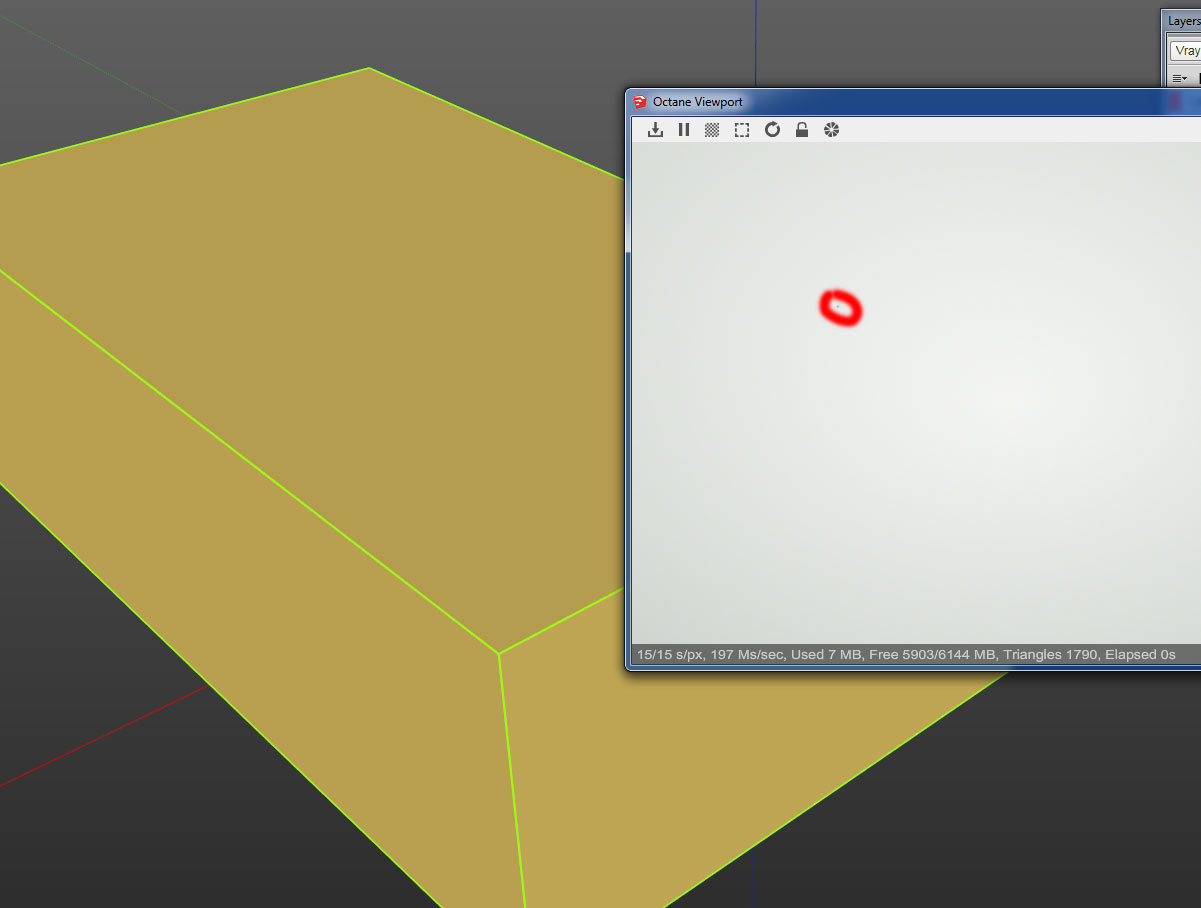

I just tries proxy from a larger box to obj - there is a problem with location or scale of the proxy object - I marked it with red.
- CaptainCrowbar
- Posts: 144
- Joined: Sun Jun 07, 2015 10:38 pm
Which version of SU are you using? Did you activate it in Preferences?

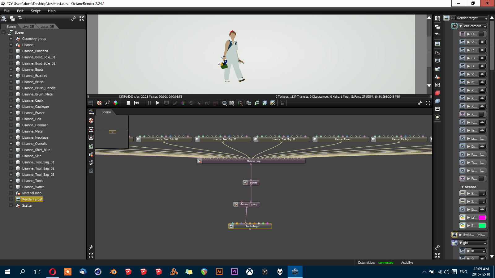

I have it working on my home laptop. It works with a simple geometry. I'll try next with a more complicated, 3d even, file.
Thanks for your efforts Captain Crowbar
https://youtu.be/Y-q8tVBgCEw
Edit - Opening the ocs file within standalone is like poetry. Finally fixed that previously atrocious hierarchy! Kudos!
