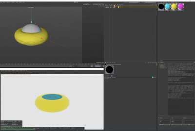

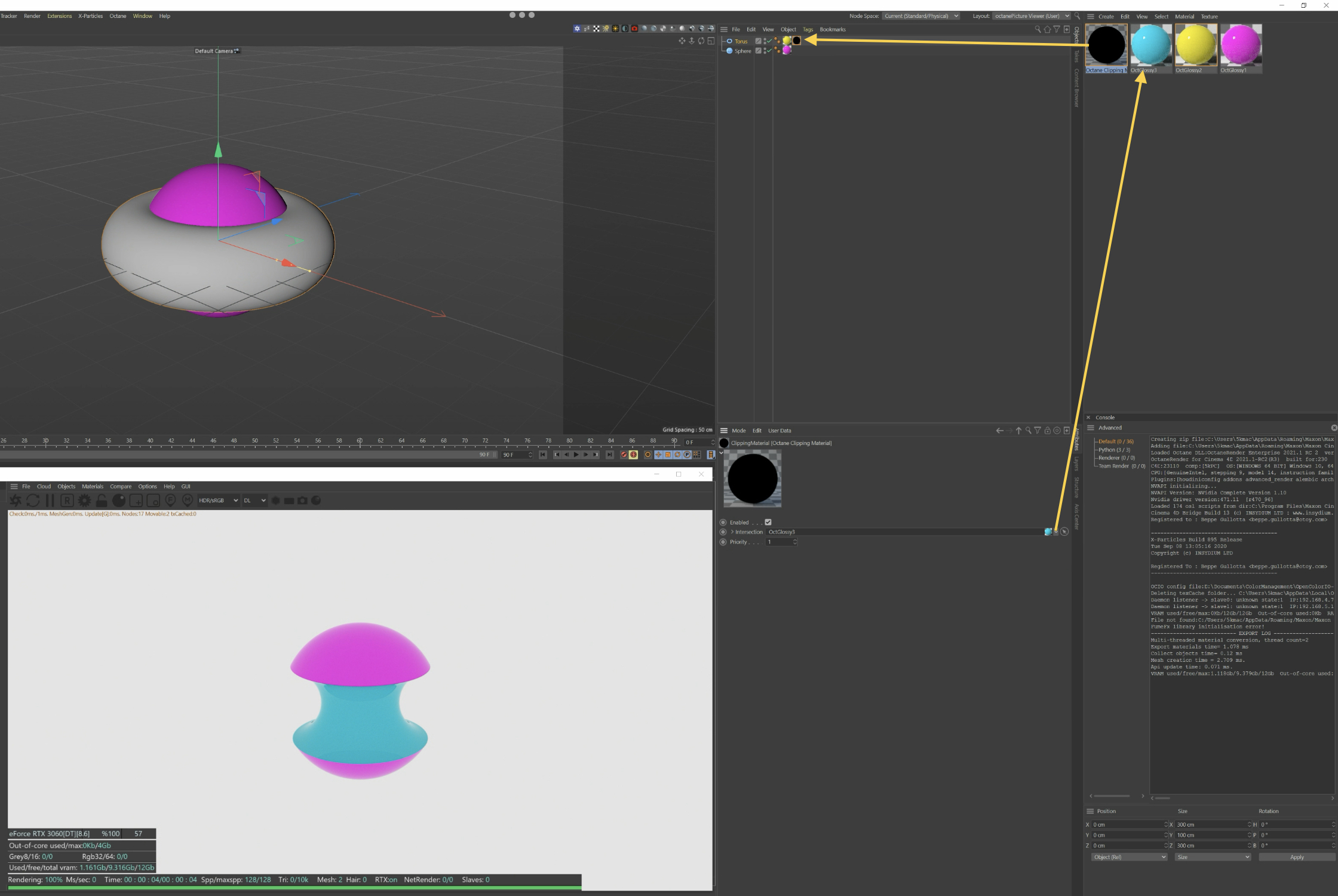

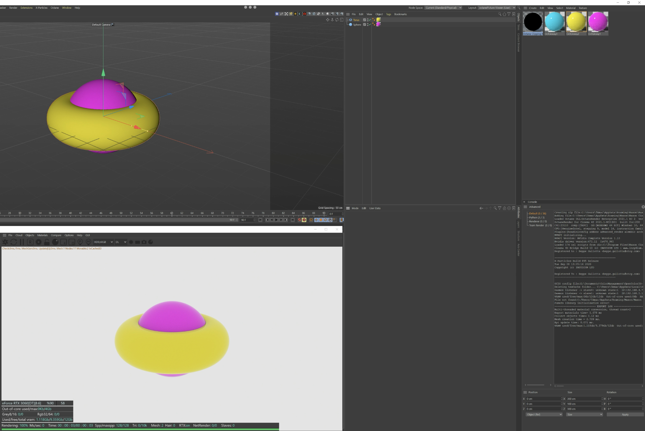

let's say you have two objects, a Sphere and a Torus, overlapping each other.
If you assign the Clipping material to the Torus, it will be boolean subtracted from the Sphere, and you can assign a different material for the intersection:
If you move the Clipping Material tag to the Sphere, it will be boolean subtracted from the Torus.
ciao Beppe

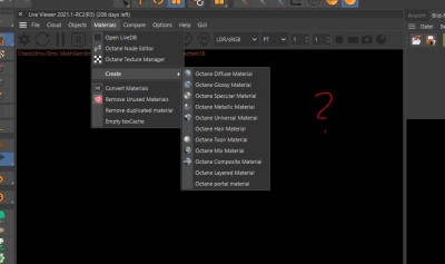

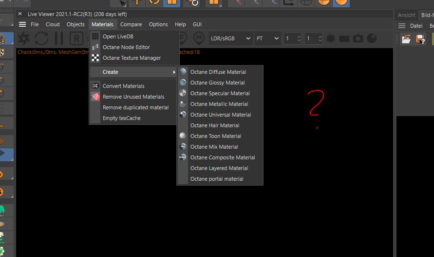

My Problem is: where do I find that "clipping´" Material?
Cannot find it under "Create Materials" not under "Octane Tags" also not under "Material Type"

The Clipping Material node is currently available from the node editor. Just add the node to a diffuse material (no need to make an actual connection). The diffuse material will then be updated as a clipping material. Select the clipping material node, and choose the replacement material to be used in the voided areas). As Beppe has shown in the screen capture, place the color tag before the clipping material tag on the object.

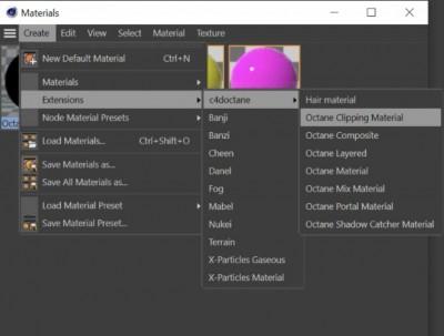

Posts: 10569
You can also create the Clipping Material in Material Manager menu Create/Extensions/c4doctane:
ciao
Beppe
