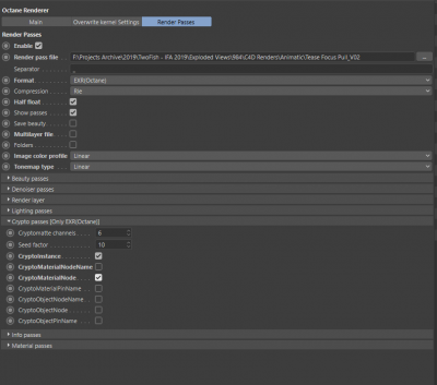

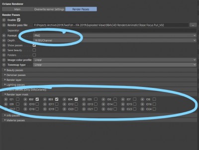

Hi Beppe, thanks a lot for your reply and effort. Sorry if i was unclear but i'm looking for a way to render cryptomattes plus Layer masks (Seperate B&W image per Layer ID), see image. The problem is that when i select "EXR(Octane)" it enables the cryptomattes option but hides the "Render layer mask" section, see image attached. When i switch back to "EXR", it re-enables the Render layer mask ID's but you're not able to render cryptomattes. Is there a way to get both?

Render layer masks are not calculated with Octane engine, but with c4d internal render engine, so are obsolete and incorrect...I don’t know another way to explain this :roll:
