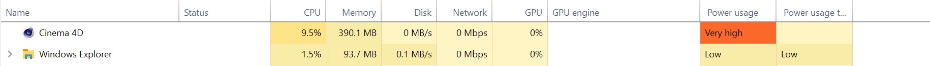

Been having this weird problem where I'll be working (with Octane open) and C4D R21 unexpectedly crashes with any warning or error. After this certain crash, C4D refuses to open and just hangs. No initializing layout screen, it just hangs. I've tried uninstalling C4D many times, tried using latest 2018/2019 but the same issue happens. It's a specific one because after the crash, I can't get C4D to open unless I sign out of my restart my computer or sign out of my Windows user. I've attached the bug report below and an image what what it looks like when try to load up C4D after the crash. I'm thinking it might be Octane related because it only happens when I have Octane LV open. Would really like some insight into this on what could be possibly wrong (or what I'm doing wrong). It seriously kills productivity when I have to sign out and close all my programs just to jump back into C4D again.

Still having the same issue. I've taken notice that It's happened when the LV is open and I try to use the "v" shortcut in Cinema 4D to switch between projects. Same immediate crash, and Cinema won't open unless I restart or sign out. I've tried the new Nvidia driver, but it's still the same issue. If something else triggers this crash, I'll update. Would really like a solution because this is extremely inconvenient.
