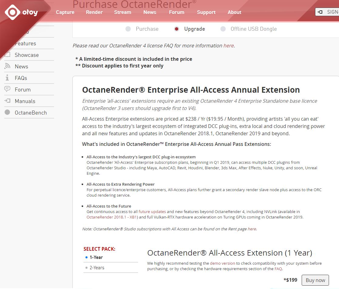

all You need to get is one of these: https://home.otoy.com/render/octane-render/purchase/hpeskobar wrote:Can someone post the right link on what to purchase for cinema4d plug in
For 3 GPUs and up
It’s so confusing
or if You already have v3/v4, simply choose upgrade and take Annual extension:
