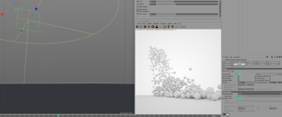

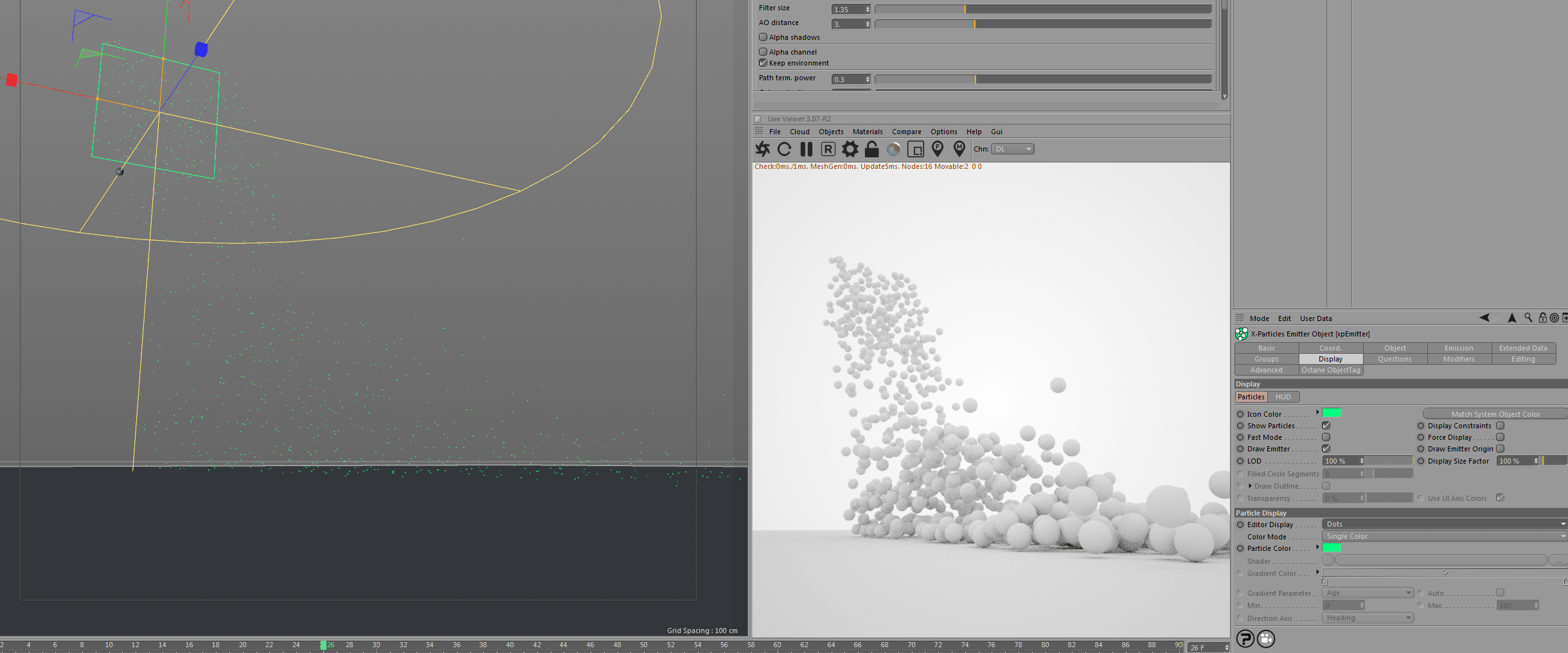

Hi, Ritchie!
Here is a screenshot.
Sphere radius and emit particle radius are set to 1cm, dispay is set to dots.
Looks like works fine
