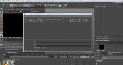

Sorry i couldn't understand what's problem. See image. And you can select and link from right manager in window. Aso after latest service packs of C4D no need to use this window anymore.

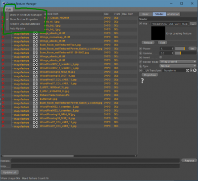

Octane Texture Manager. No "ReLink Texture" option

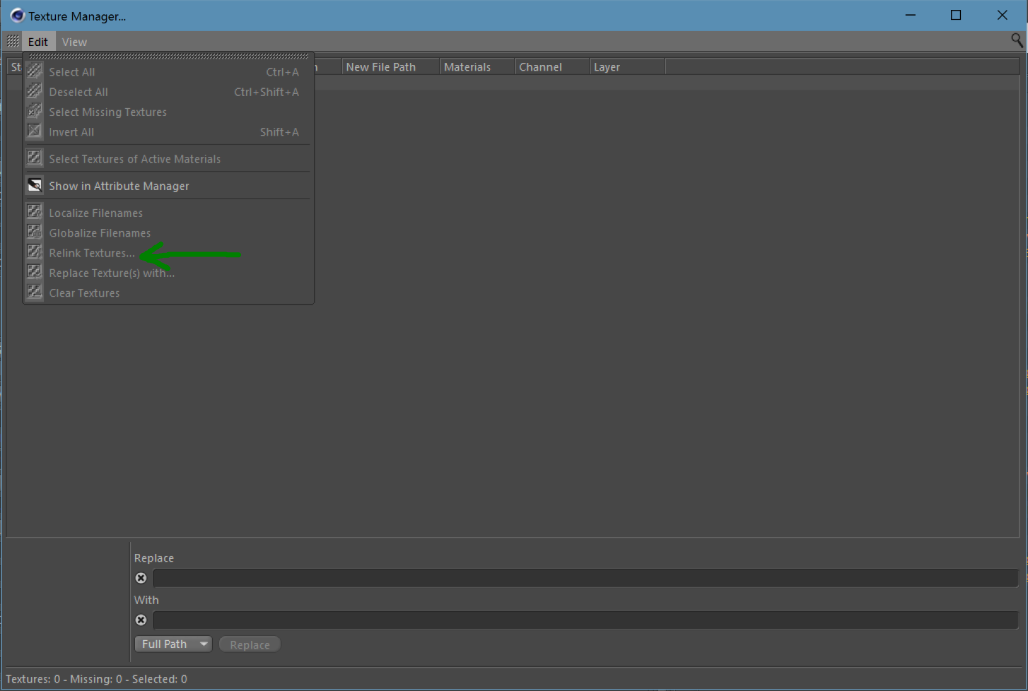

C4D Native Texture Manager / Relink Textures option is avaialable

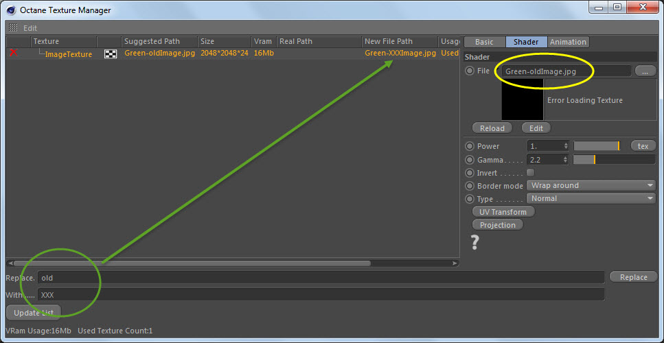

i had the same problem. my solution was easy, in Octane TextureManager on the bottom, the replace/with input field. first the old path and second the new path, then replace start.
