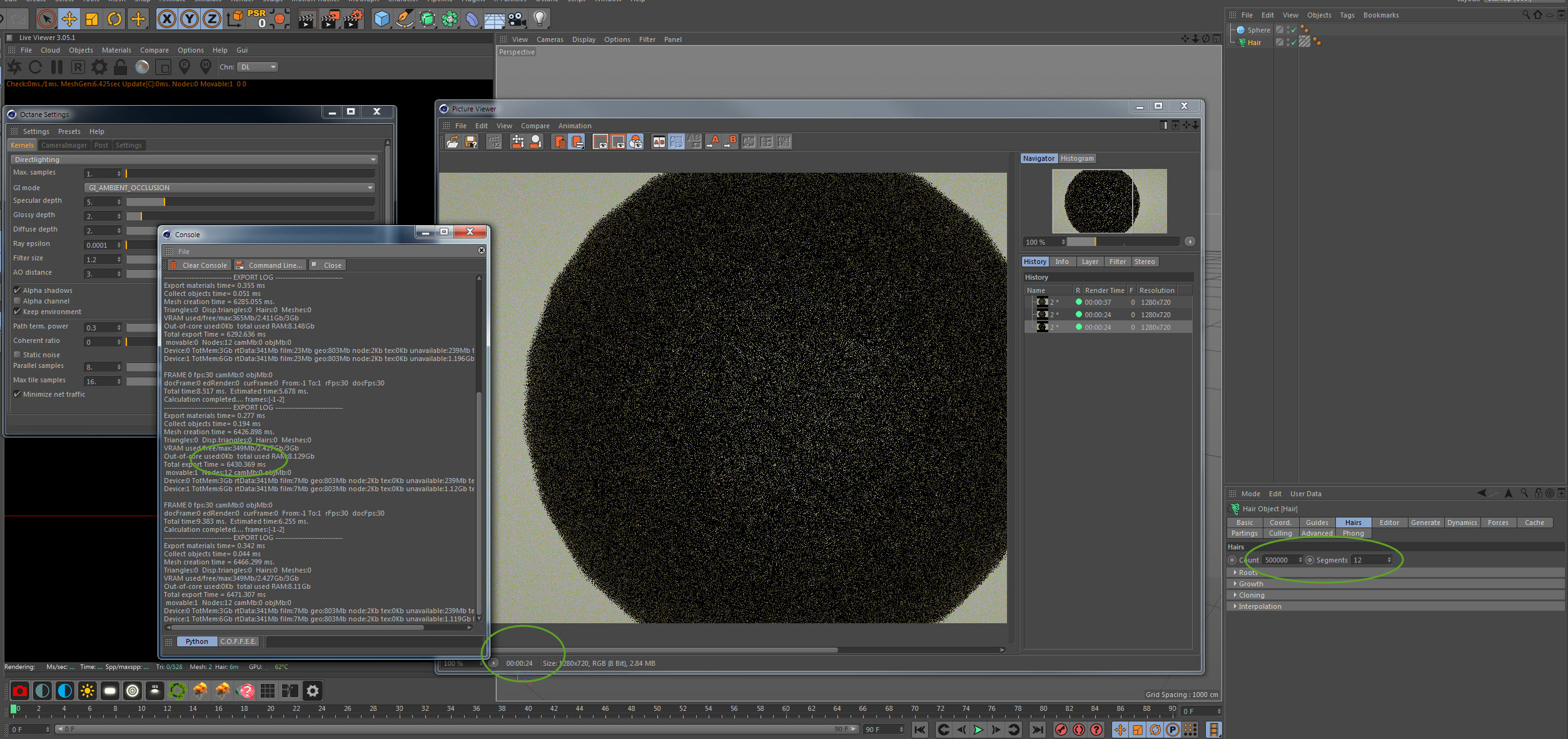

My test results are attached. It's not 2min. for 1millions hair. You may have more segments.

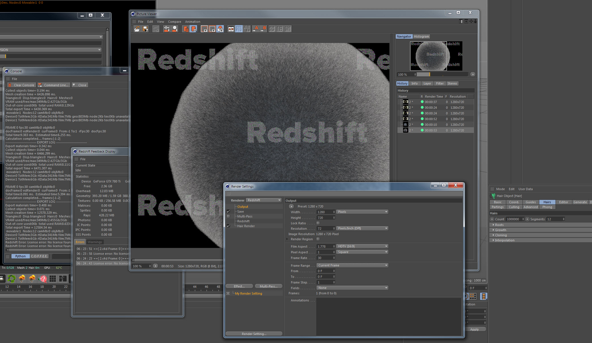

Also how do you measured RedShift? It doesn't seems so fast as you said. See next image.

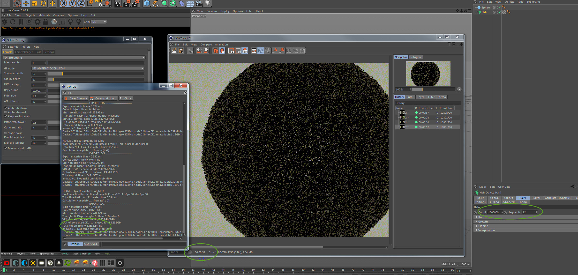

ok sorry, i use bucklet render!, now redshift in a progressive start at 00:51s
but octane start at 1:55s
redshift progressive
octane render

I get similar results but a bit better for Octane on my computer. When you see updating/etc.. this means that plugin finished own job and waiting the process in the renderer. So plugin side is fast as or faster than others. Scene preparation process is always slower for geometries and even hair as we can see.
