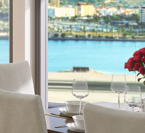

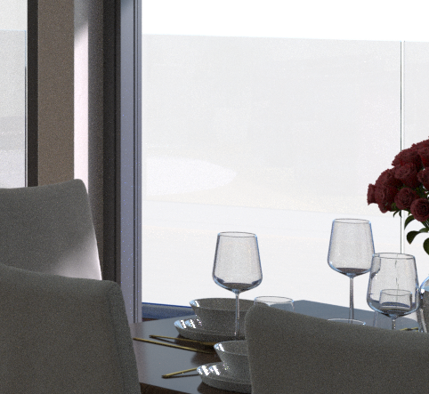

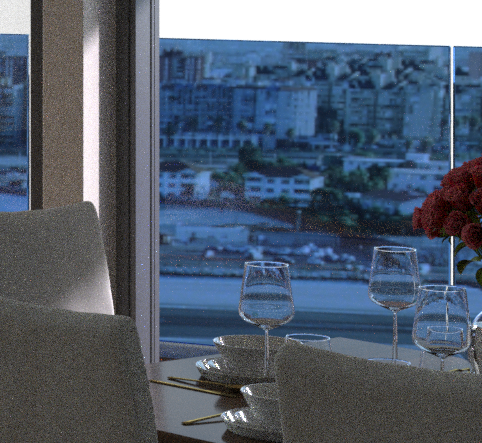

I'm having an issue with coloured glass. When I save the image with the alpha channel enabled, the glass has no colour. When I save it with alpha chanel disabled, the colour is there. The problem is that I don't want the HDRI included as I want to place a background image separately in Photoshop.
I've added some crops to explain what I mean. As you can see, the image with alpha channel diabled shows the blue glass as it should be but the one with alpha channel enabled shows it without any colour.
I'm using absorbtion medium to get the colour but I've tried it with transmission and it has the same result. I'm using the Pathtracing kernel and I have fake shadows enabled. Switching off fake shadows has no effect. I've also tried a separate HDRI for the background set to Visibility Environment but with no success.
Does anybody have any suggestions?
Thanks,
Rico
Alpha Disabled
Alpha Disabled
Alpha Enabled
Alpha Enabled
Composited Image
Composited Image
Alpha Enabled With Affect Alpha Disabled

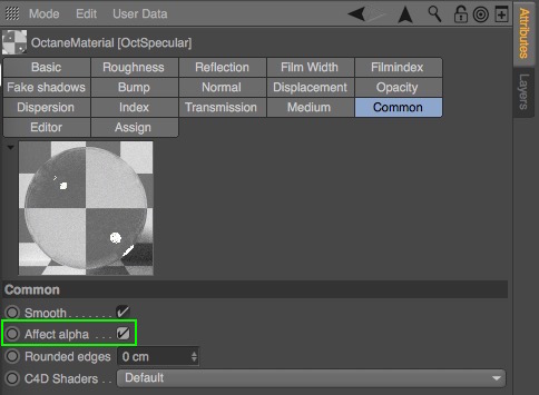

Hi rsuleyman,
enable the Affect alpha option in the Common tab of your specular material:
ciao beppe

bepeg4d wrote: enable the Affect alpha option in the Common tab of your specular material
Thanks Beppe,
But I should have mentioned that the first three images in my initial post were with Affect Alpha enabled. The problem is that the colour of the glass isn't there when the alpha channel is applied.
Rico

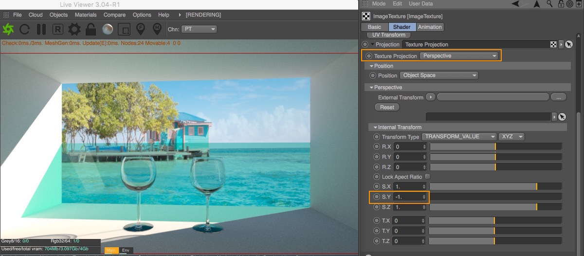

Here is an example scene:
AffectAlphaRL.zip
(2.45 MiB) Downloaded 526 times

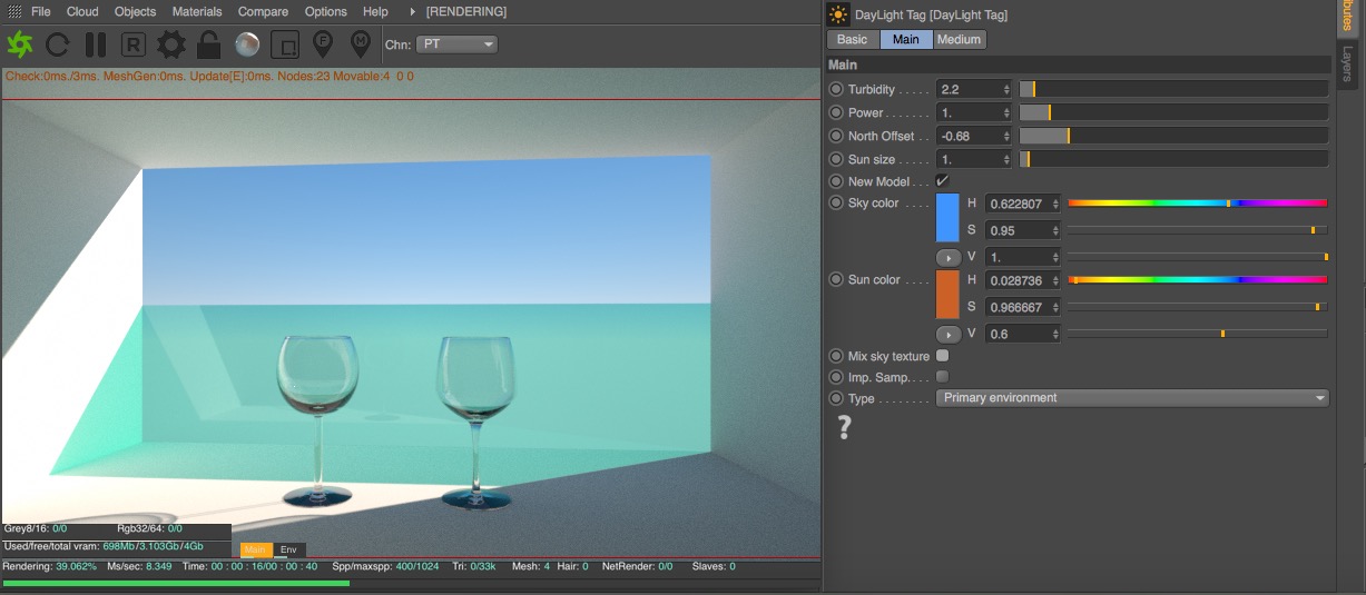

The Primary environment is the Physical sun (but can be also an HDRI):
the Visible environment is a Texture environment with a generic 8bit image file:
The projection is changed from Spherical to Prospective with negative Y axis:
All the Visible environment option are active so the background is also visible in refraction and reflection.
What do you think about this solution?
ciao beppe
