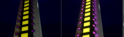

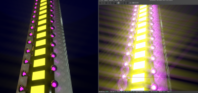

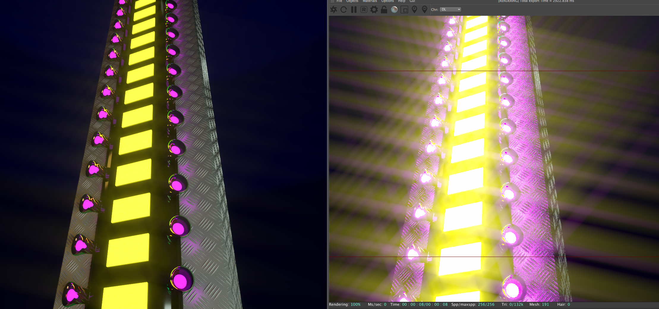

Hi mates, thanks for the responses,
here's the screenshot, I'm stuck here I checked everything!, it seems a bug, In octane's live viewer I get the lights (difusse material with blackbody emission) with, post fx etc, but when I render in the C4D viewer they are gone.
I think I'll have to upgrade to v3 but will it solve the issue?
yes sorry, using 2.25
thx!

Posts: 10587
Hi deifgiri,
adding a screenshot is always a good idea :)
Check your Octane render settings and in particular, the Geometry Engine:
https://docs.otoy.com/manuals/products/ ... rendering/
If is setted to "Send all scene data", all the geometry is collected in one single object and the power of the emission is divided by the number of emitters losing power.
So the emitters are to weak and the Post effect cannot work as expected.
ciao beppe

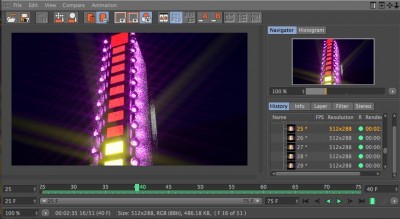

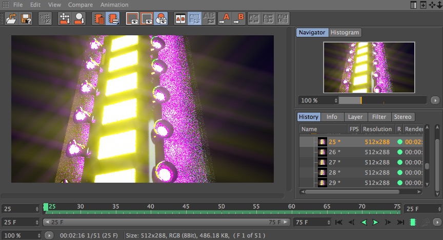

deifgiri
Posts: 10
Joined: Fri Feb 21, 2014 9:23 am
Yes I already tried that,
changed to 'Resend only updated objects' manual , all and auto,
it renders the first frame just fine, but the following ones are dark again.
You said they emissions are weak, If I push the emission power way high, I get some light in the render, but I still can't understand why is so different from the live viewer yet,
well, I guess the scene is not well done...
upping scene

Always add object tag to emissive geometry to avoid confusions. It's about how exported the meshes to Octane scene. This different occurs If they are exported as part of a static mesh in PV and you worked with all movable in LV. See C4D->FAQ topic or read manual for animation rendering and export schema.

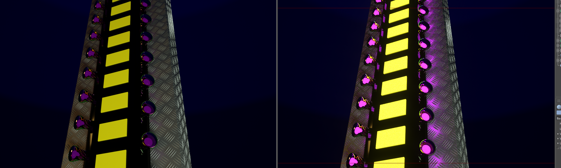

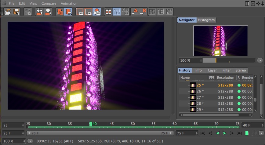

Posts: 10587
Hi deifgiri,
there is definetly something strange in your scene, the post effect is there, but the emission power always changes after the first frame :roll:
The scene still has the "Resend all scene data" option, please change it to manual or auto.
The workaround is to copy everything in a new scene, here now is working as expected.
Let me know if you solve in this way.
