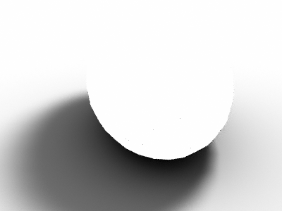

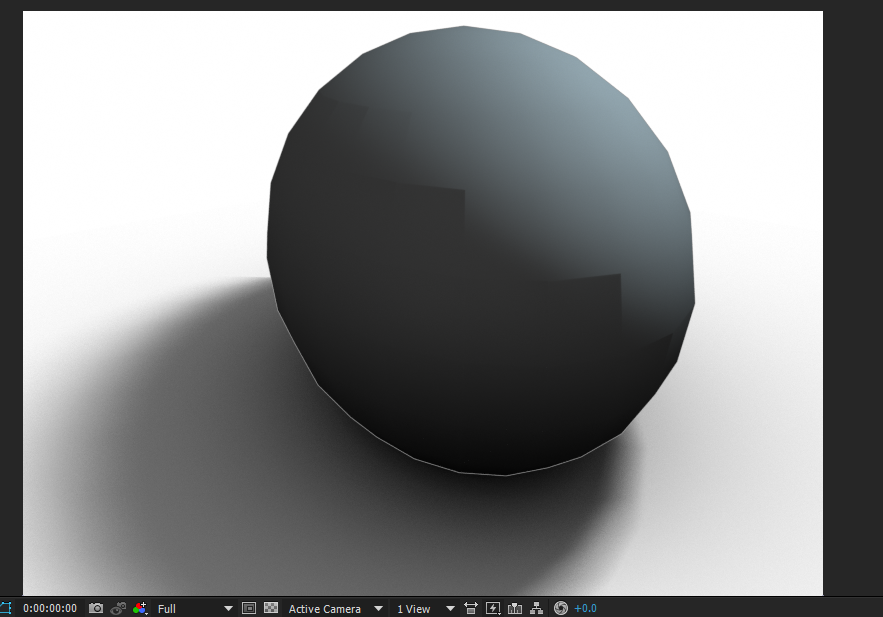

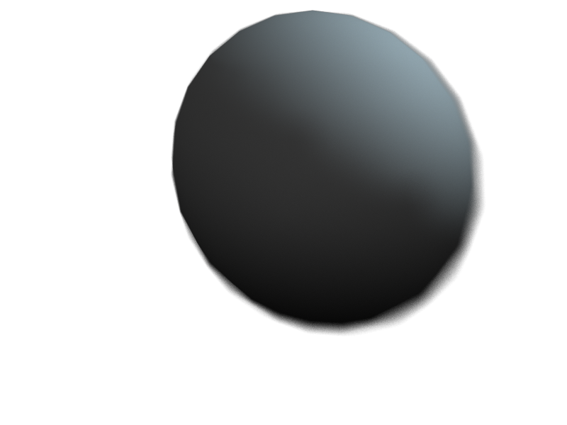

I'm a VFX artist, so I'm compositing onto live action footage a lot. I noticed that (especially when the aperture is high in octane) the shadows don't quite line up. This is killing me because I can't figure out what do do about this. When there is no DOF, there still is a small, one pixel long line between the object and the shadow. Anyone know what to do here?

I think it produces a blending to white in dof area.

This is without DOF. Still strange. Hmm.

I think the sample weights in the shadow passes are incorrect. I will have a look at it.

Ok, after some fiddling around with the render layer passes, I think I've got it fixed. Attached you will find the main and the shadow pass of your example scene rendered with the fix. Would that work for you?

That is exactly what I was wanting! Would you mind explaining how you did it so I can render it out like that? Thanks so much!

I fixed the splatting in the kernels. There is nothing you can do right now, except making the geometry of the active layer invisible to the camera and then render the shadow passes separately. The fix will be available in the next release.
