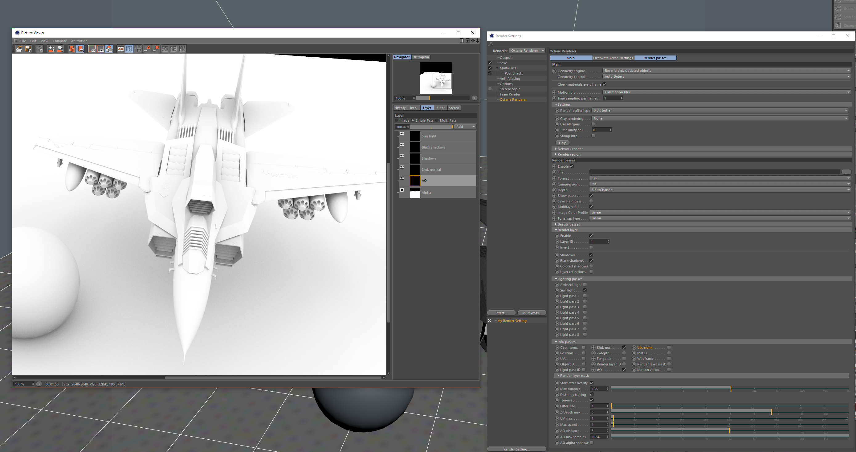

Hello
No matter what I try, the shadow passes show just blank
The black shadow layer shows pure black, the shadows layer pure white, and the colored shadow layer also dosnt work
All other passes seem to work fine. All the preview images aside of alpha show only black for some reason too. The non shadow passes seem to all work still.
Here are my settings:
Using R16 on Win10 with 4770k , GTX 980 ti , 32 GB
Btw is it possible to render out shadows without the object they are on, like this ?
Anyone an idea ?

What is different than I supposed ?
I need shadow passes because I need isolated shadows
Im not sure if I understand what you mean with the render layers. My settings are on the screenshot, if there is something wrong I did, it should be visible.
I tried assigning the ground different layer IDs than the object and vice versa, but nothing had any effect on the outcome.

So is there a way I can get the final image + shadows on alpha ? Like the previously posted image ? Because thats actually what I need, not the seperated shadows.
Check render layers or matte option on materials. See videos for details.
