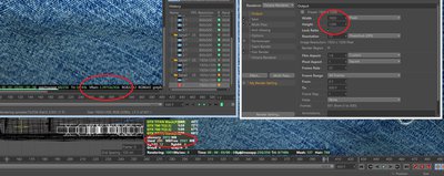

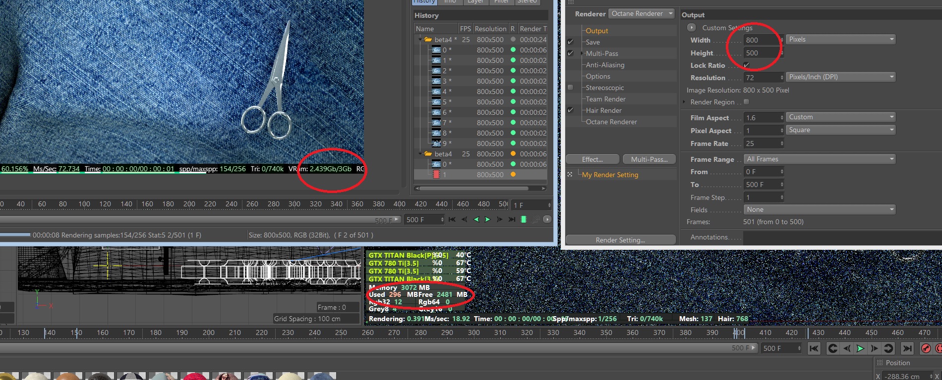

Here are two screen grabs.
The first is a render at 800x500. You see in the LV im using 296mb, but in the picture viewer 2.4GB.
In the second shot I am rendering at 1920x1200. LV is about the same at 295mb, and pretty much the same again the picture viewer. 2.4GB.
Is this correct?
Ten
( PC ) i7 5960x octal 4.5ghz / 64GB / 2x Titan X 12GB / 1x 780 6GB - ( Laptop ) i7 4790k 4ghz / 32GB / 980M 8GB - Octane CD4 2.x / C4DR16.x / win 8.x
Posts: 16068
Location: Türkiye
yes, it shows free/max vram. This may be confusing for the people.
