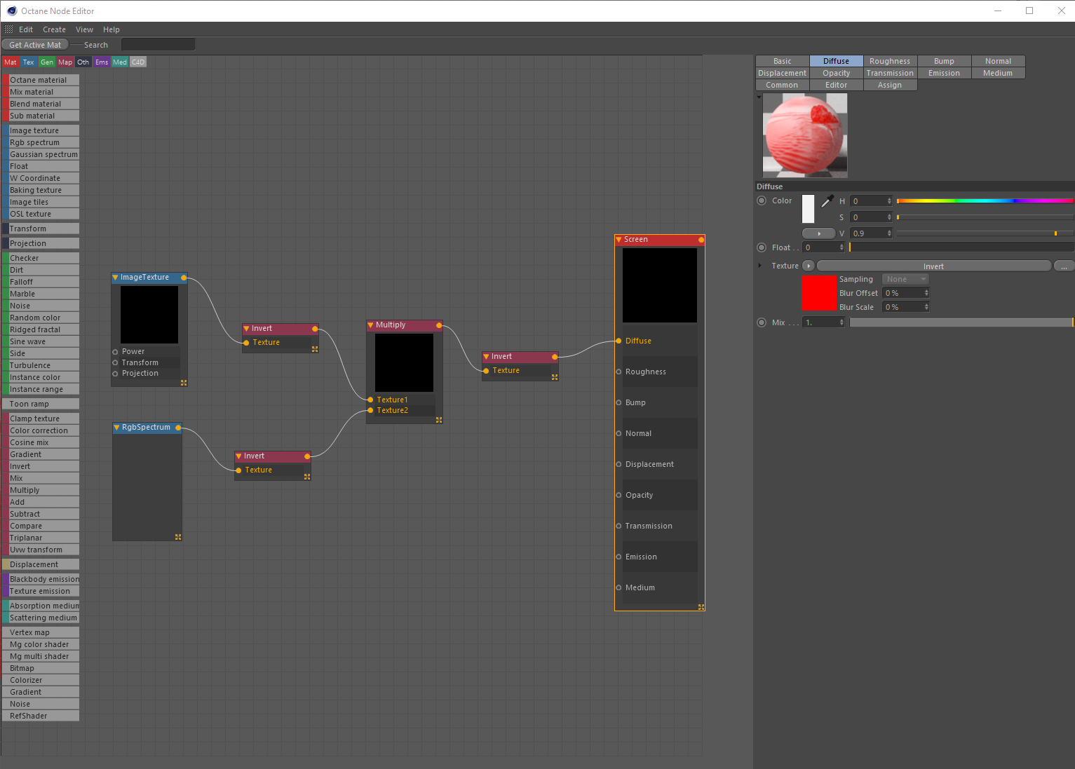

Here is a scene file with a texture using Screen Blend Mode (replace the ImageTexture & RGB Spectrum nodes with your textures):
Octane_ScreenMaterial.zip
