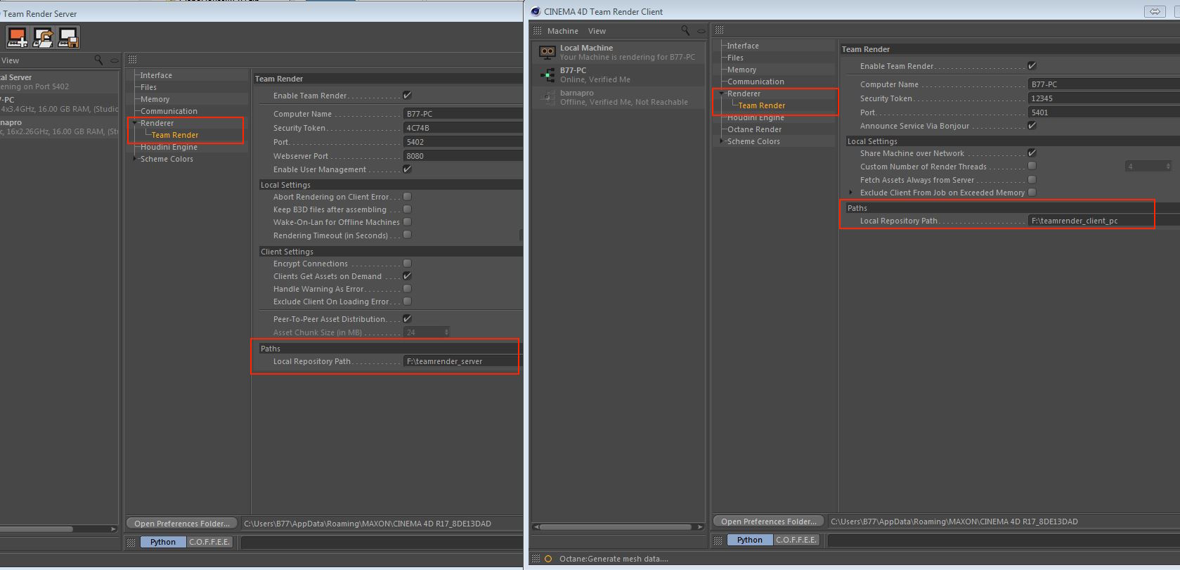

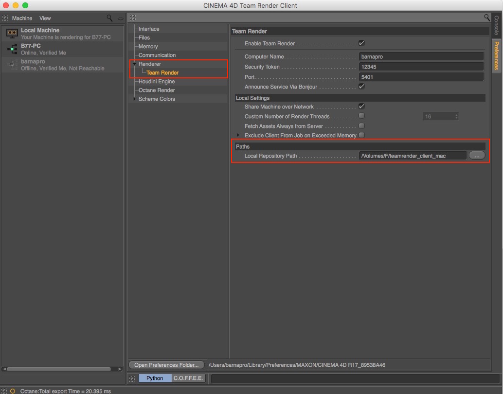

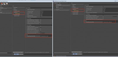

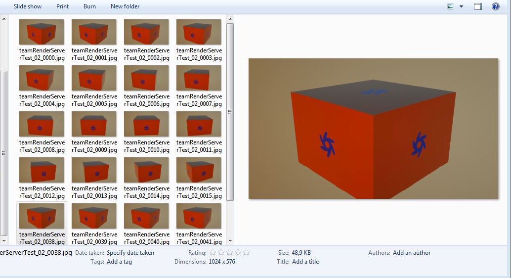

Anyway, on a second try, it seems that, changing the default paths from the hidden write protected nonsense directory, and moving all of them on an external hd viewable on all the network, completely solves the issue:
The tex folder is not created in all the clients folders, but seems not to be necessary.
ciao beppe
