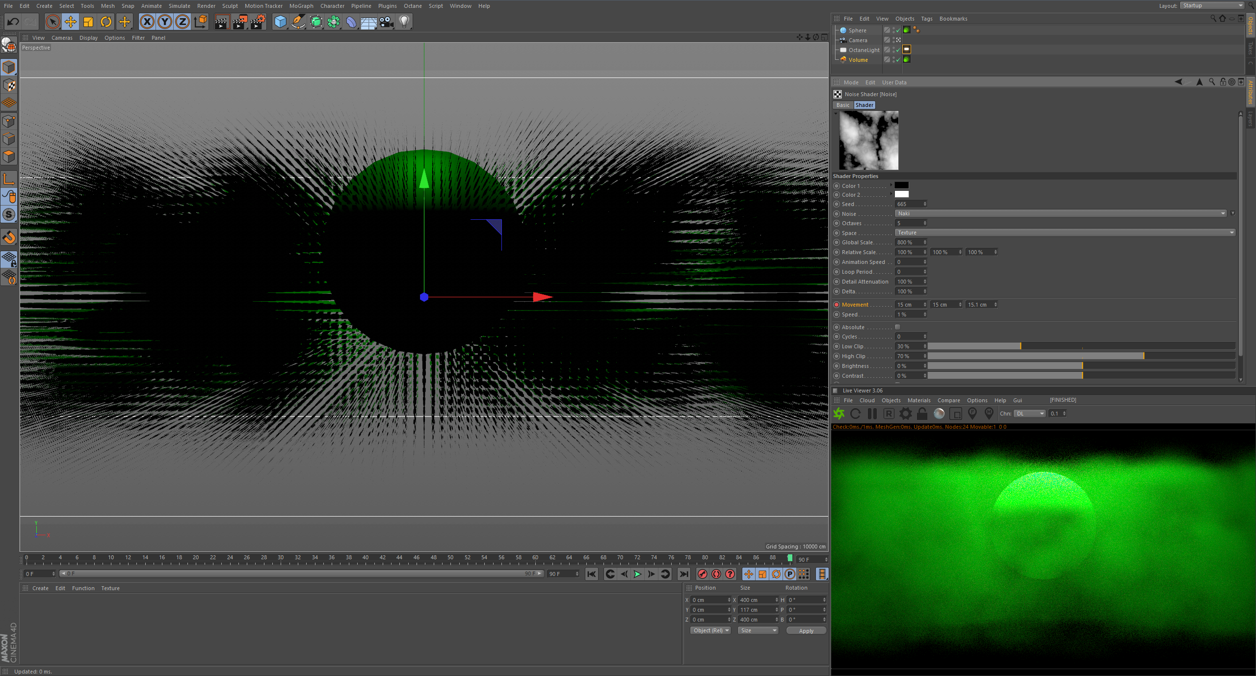

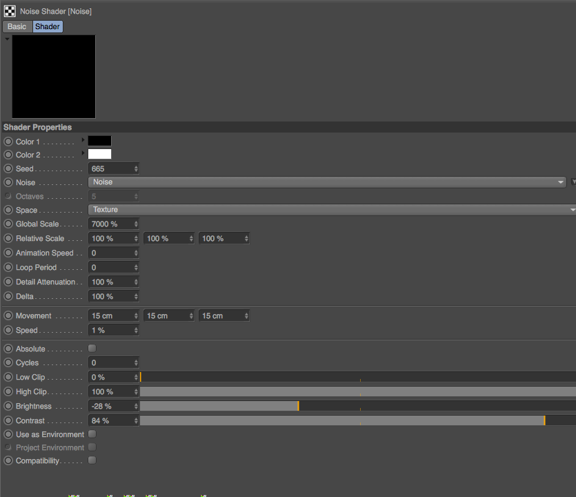

I've got a animated noise material (speed/movement -> see attachment) and I can't get the animated noise to render properly.
Just add 2 keyframes at start and end of animation with slightly different values. I usually do it on the movement parameter on one of the axes... In your case I can see u have 15 in the movement, so I'd add 15 at first frame, and 15.01 on last. This way the change will be insignificant visually, but will trigger refresh on the texture.

I keyframed at start the "movement" (15 cm for exemple) and another keyframe at the end (15.1 cm), nothing moves in the live viewer.
"Animation speed" set to 0.2 is working but thats not what i am trying to achieve. I want to use the movement on a certain axis of my noise.
