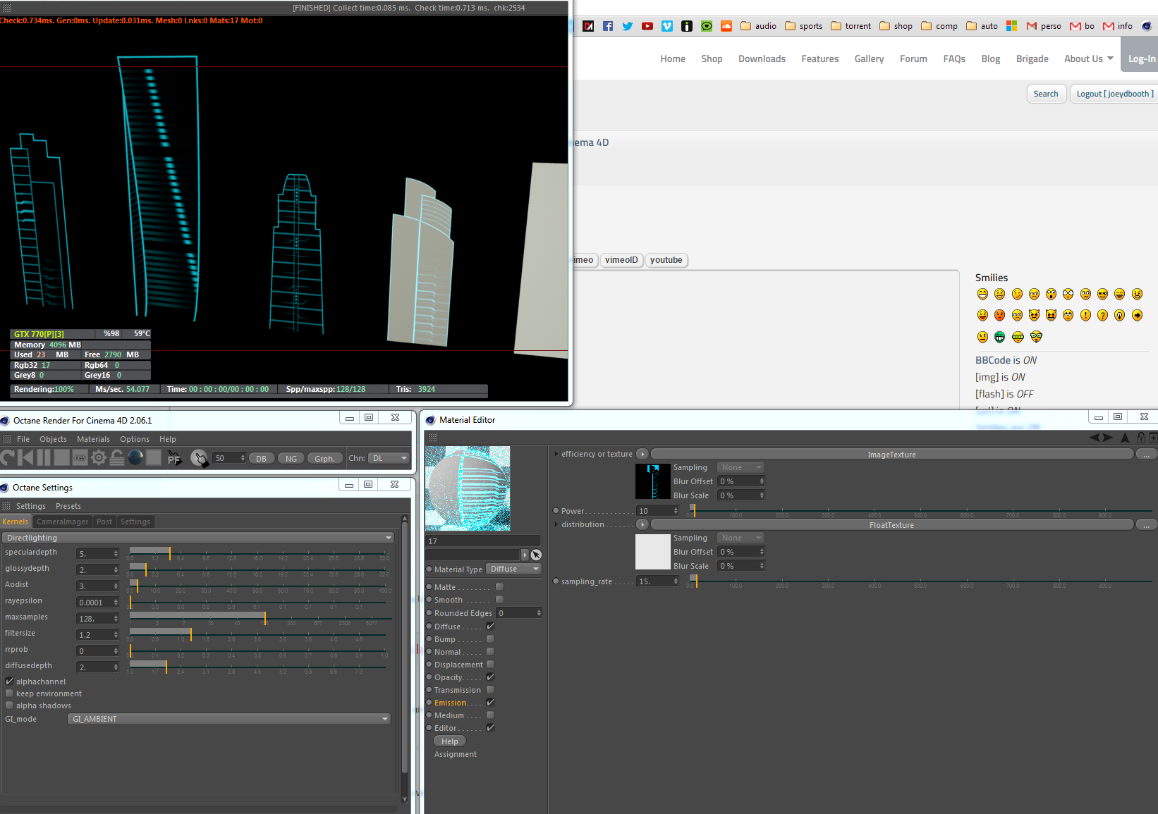

unfortunately, low emission values made my plane almost invisible.
i included a picture to show the difference.
the result on the left is just diffuse and opacity and the right is opacity and emission.
it's a fast render at the moment, i just have A LOT of frames to make and i want to optimize everything (i don't have the best card on earth either)

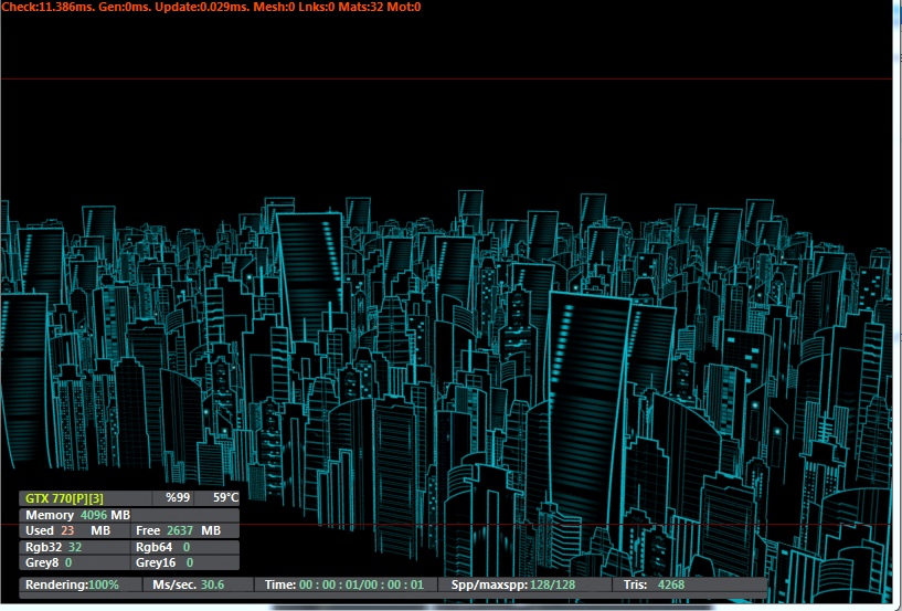

alright thanks aoktar, i decided to stick to my simple diffuse + opacity combo with gi + ambient.
the city is coming along tho and it does RENDER FAST!
looking forward to simple luminant textures in the future, the 360 camera really is a cool feature to play with when you can fly around countless geometry!
