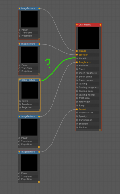

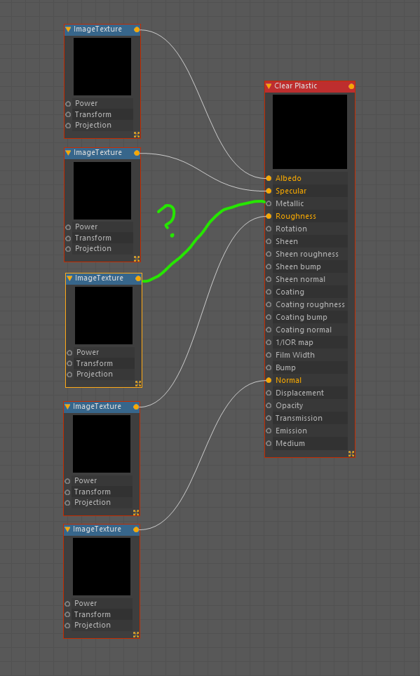

With this code I can add a bitmap shader for the Specular Map, but it doesn't have an ImageTexture to connect as you can see in the Node Editor image.

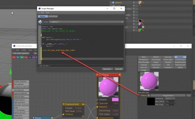

Posts: 16067
Location: Türkiye
You can see every IDs by dropping to script manager. See picture
