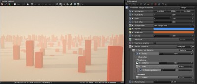

Oh sorry, shame on me
I have prepared a simple scene some days ago but i have forgot to share it
Basically you have to play with higher Phase values, here is the example: ciao beppe

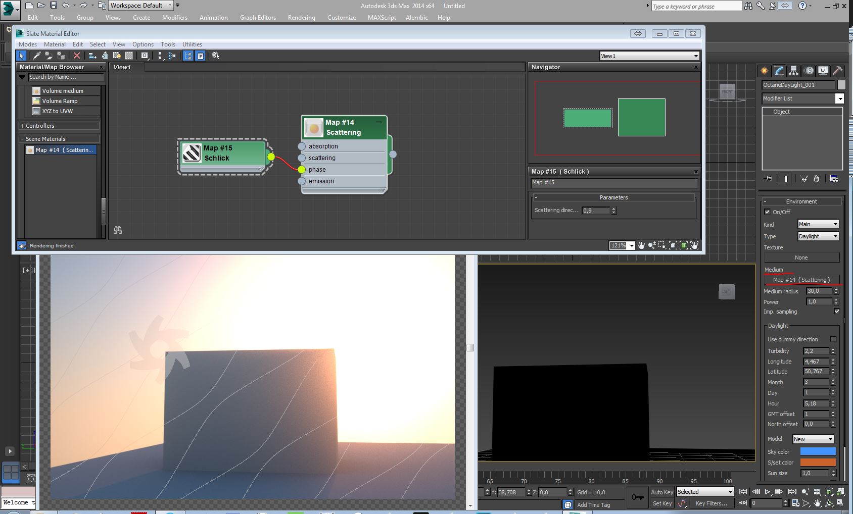

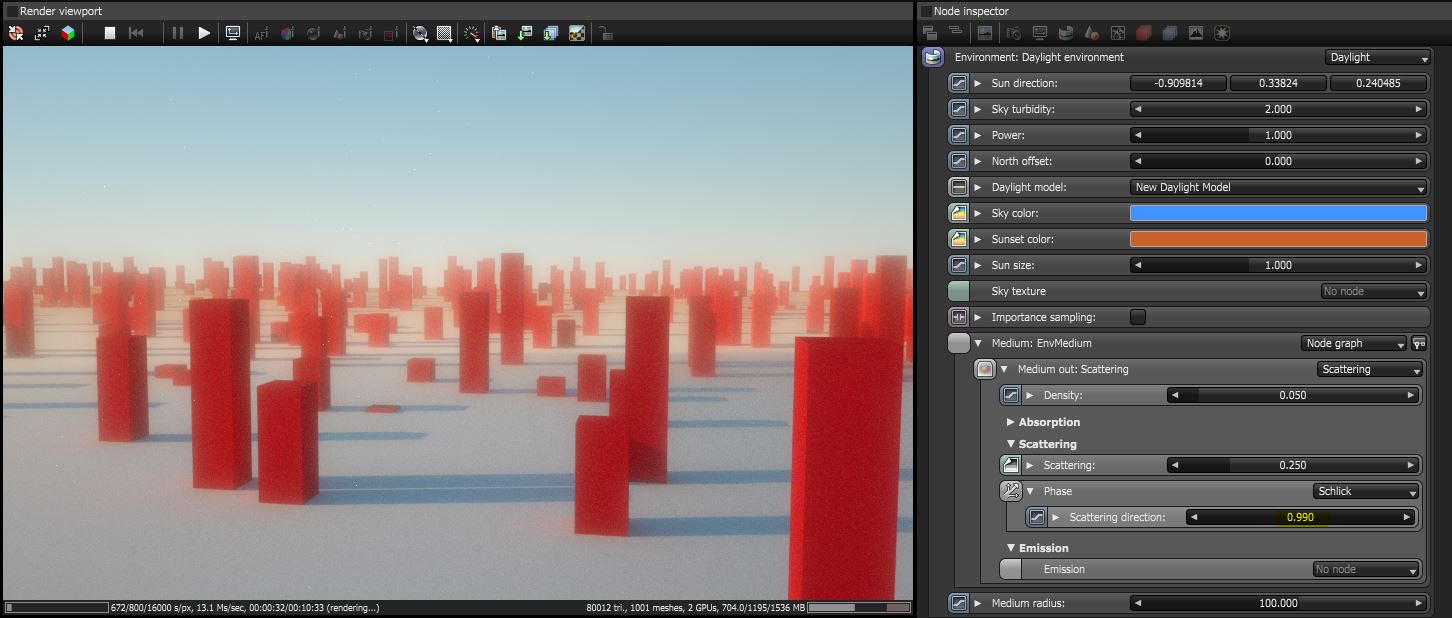

Hi coilbook,
you have to add a scatter node in the medium slot in the Daylight, and then add a Schlick node in the Phase slot: ciao beppe
- muchogrande
- Posts: 61
- Joined: Wed Jan 14, 2015 9:19 pm
Is this possible in C4D? I can't find a way to add a Schlick node in the Phase slot...?
