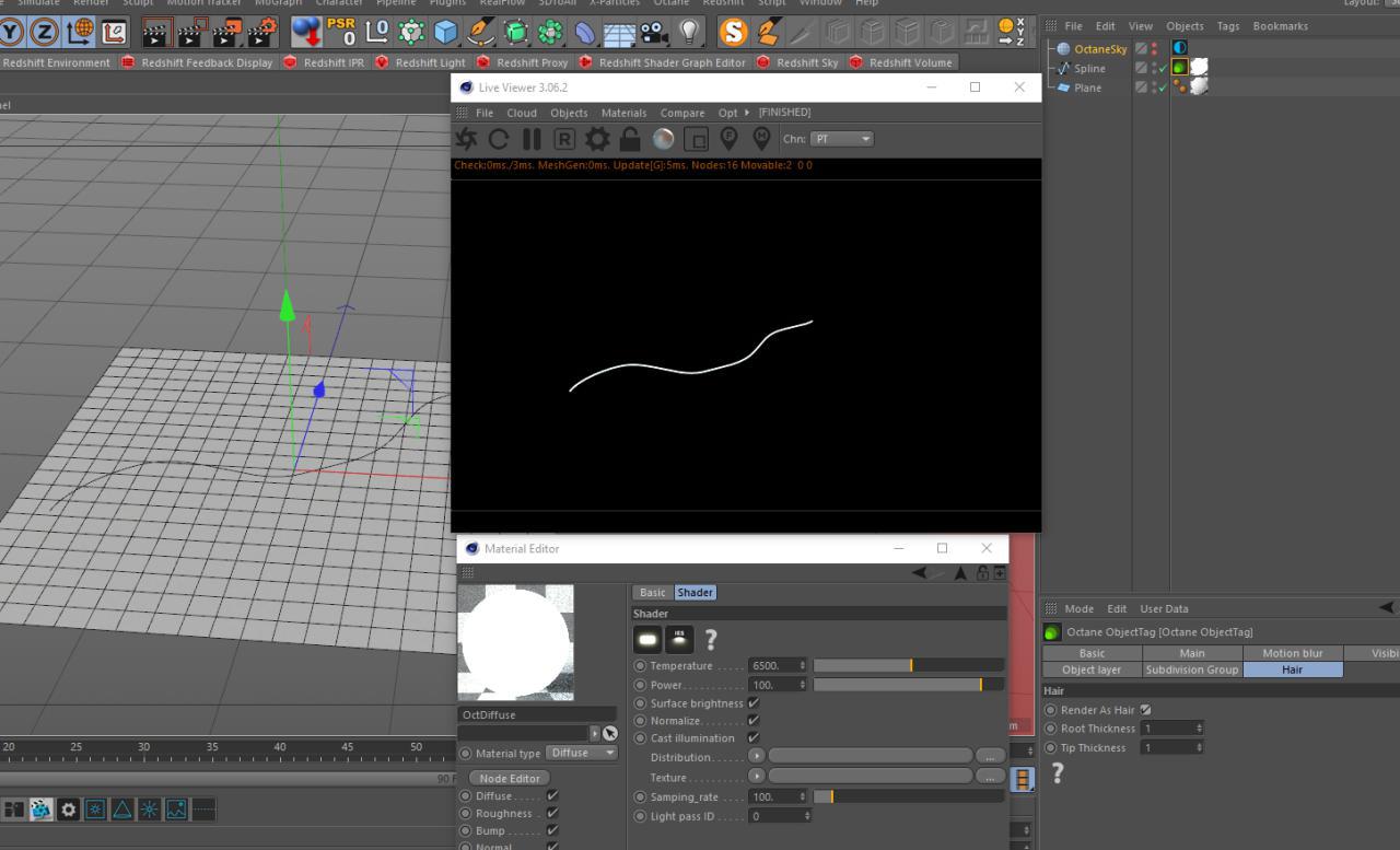

aoktar wrote:Have you tried the blackbody emission with "Surface brightness=ON"?
not working
Win 10x64, AMD 1950x 16C/32T, RAM 32Gb, RTX 3060x3
Octane-for-C4D(R23.110)2021.x.x, Cycles4D, Centileo. Nvidia 472.47 STUDIO
Posts: 16063
Location: Türkiye
not working
Answer is NO for this case from devs. Hair primitives are not supporting the casting of any illumination.
