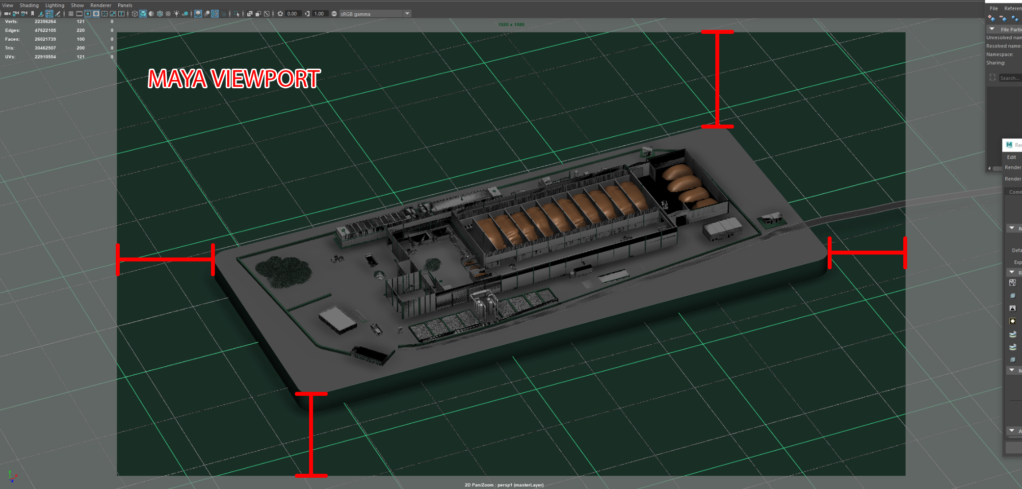

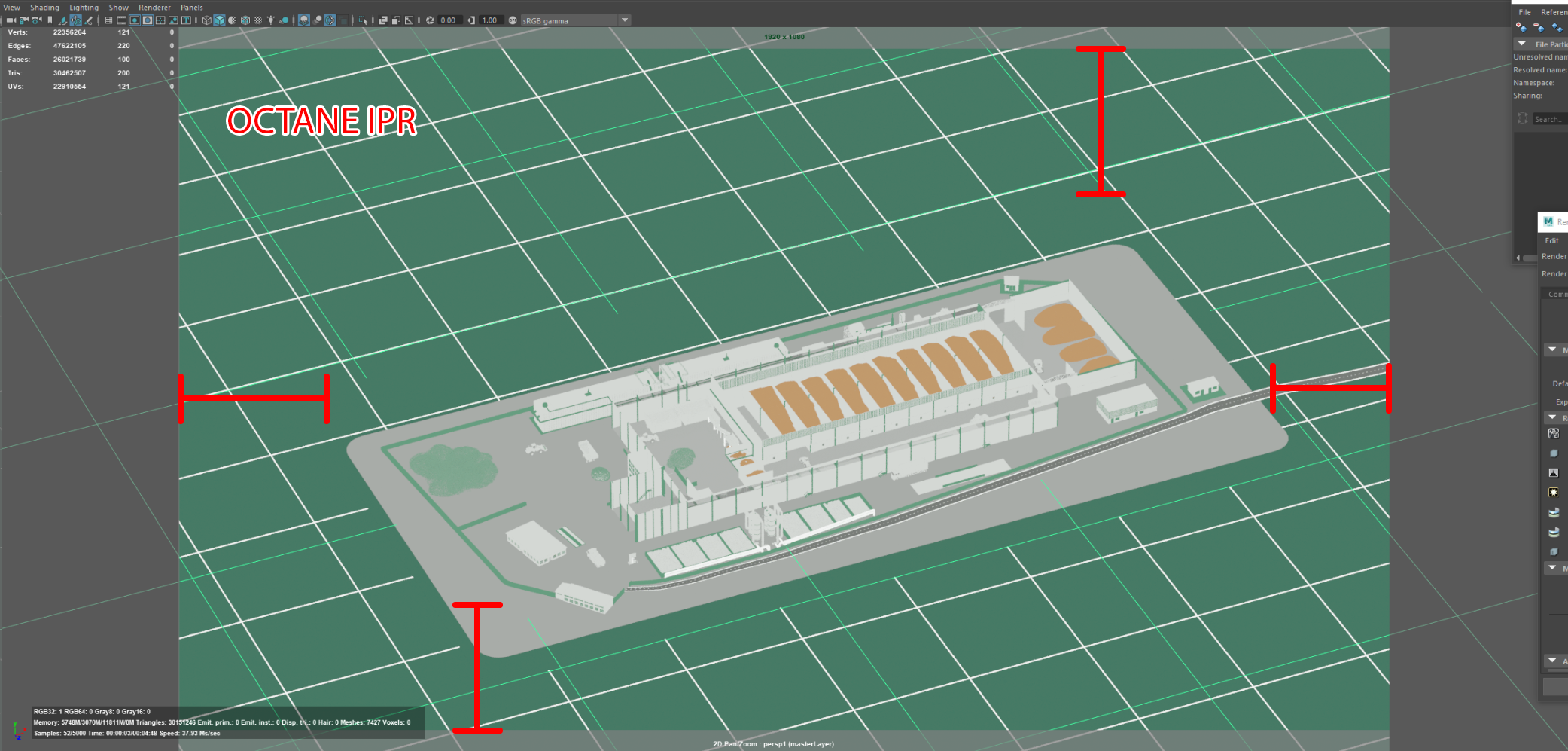

hi, I'm desperate for a solution to this: the octane render camera appears to be TILTED in comparison to the maya viewport. There's no pan applied (intentionally).
I tried everything I can think of, but nothing seems to solve the problem.
This happens both in IPR and in batch render, ONLY with octane. Maya Hardware is working properly.
What I've tried:
- different cameras: not working. I tried new maya cameras, new octane cameras, new scene + new camera.
- imager options, doesn't work. With a brand new imager, the problem persists
- post processor options, couldn't find any related attribute
- camera options of maya: there's a 'pan' attribute, but it doesn't seem to work. anyway it does not affect my render
- viewport options: couldn't find any useful attribute, everything is set to default options
Camera settings, if useful, are usual, but the focal lenght is super zoomed because i need an effect similar to the ortographic view. So focal lenght is 230 and Angle of View is 6.32, camera scale 1.

Hi, no problem!
maya 2018 update 6. We installed the latest NVIDIA drivers.
GPU temperature is normal, around 70-80 degrees.
We have never had any similar problem, only with this scene.
Again, sorry but I can't send it to you.
We have worked around the problem by creating and tweaking a little bit a new ortographic camera, which seems to work just fine
