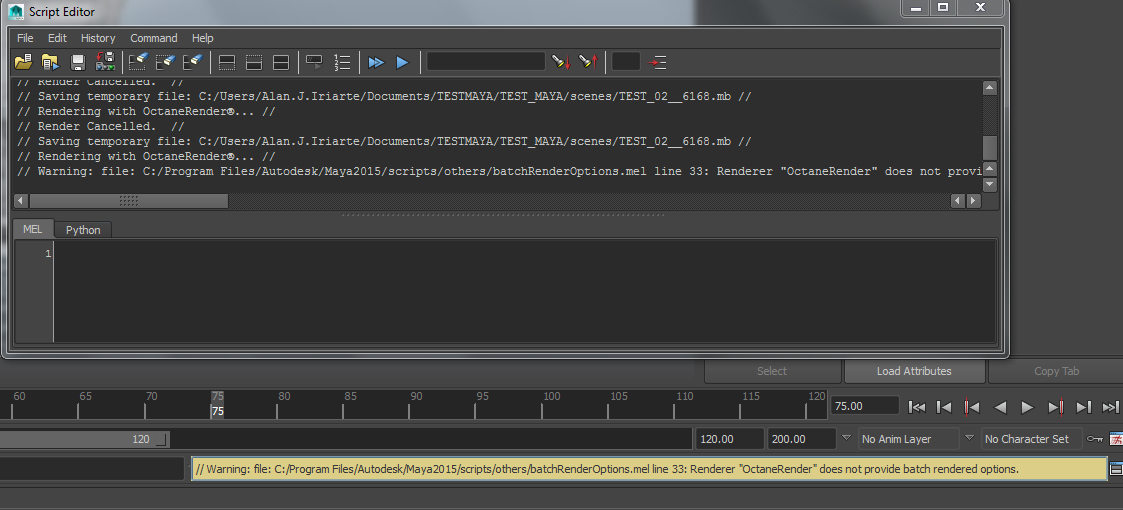

batch render maya octane solutions!!!
I have spent 400euros to amaze render speed . I have a video card titan Z and it's crazy speed. now I want to throw a sequence render the batch render and it appears mistake!

You are just trying to open the batch rendering options instead of starting the batch render itself. Octane does not provide any additional options specific to batch render, as all options needed for Octane - are set in general settings and inside the scene itself.ALANCGSENIOR wrote:batch render maya octane solutions!!!
So, to start the batch render - just choose the batch render menu item itself, not the little square next to it (instead of starting the action immediately Maya opens the "options" dialog of the action when you are pressing this square).

Sorry , I misunderstood , could you show me a picture? My English is not very good
