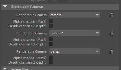

I imagine something like currently the "renderable" flag for cameras, but switched to Octane's "Render targets". Then you'd place "file name" and "frame range" into Octane's "Film Settings" nodes that already sets "Resolution" (those 3 options are closely related).
For example, from a single scene in archviz I output animations at 720p , still images in a larger and varied aspect ratio and maybe some panoramas. It'd be cool to not have to remember settings like resolution, frame range and file naming for each render output I want to "batch render".

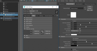

The user selects the node on this simplified outliner and use the Attribute Editor to adjust the settings of each node. Like vray's access to sky and sun in that window. But then there's the problem of unconnected nodes.

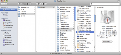

So, maybe instead of an outliner, something more like Apple's file browser (or a sort of Maya's Connection Editor / Relationship Editor):

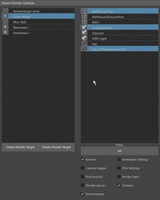

A quick sketch of how to access to the relevant network fit for "render settings" as a maya user (of course, this in addition to the UI for GPUs settings and the likes) without losing functionality (in fact it seems to me even easier to reroute some wiring - imagine you want to switch all your render targets from a preview kernel to a final one):
First column would always be Render Targets with toggles for Batch Render, and the second column would be a list of all octane nodes in the scene (even unconnected) filtered/tabbed by connection type (each render settings node, camera, kernel, environment). If you select a render target, it highlights on the second column the inputs for that target. If you select another node on the second column, you replace the connection (like connection editor) since all plugs accept only 1 input.
This UI would also have to have a way to create and delete those nodes.
Actually, we should be able to select without connecting them. We want to select a node just to see on the AE. But you get the idea. Maybe a right click context menu that allows to assign the clicked node to selected render target(s), delete or duplicate. treeView command has options for buttons additionally. And/or ctrl+left click to comply with Maya's standard for toggling selections.
I think that as far as we expect from "Render Settings", these 2 columns would suffice. Materials are already the way maya works and new users will pick up quickly.

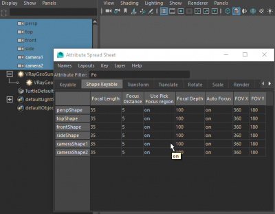

A button to open Maya's "Attribute Spread Sheet" with all nodes of a type would be dandy too.
