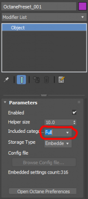

Included categories: Categories of settings to store. Select 'MAIN' for all scene related settings, or only a subset of settings. Note that Categories can only be changed when the preset is Enabled.

When sending us a sample scene with an issue, please add an Octane preset object. That allows us to investigate the issue with your exact settings.
-Open your scene
-Open Octane Preferences window
-Choose Add Octane Preset helper from the Preset menu.
This should select the new object.
Select Modify in the object panel, to access the object parameters.
Change the Included categories to 'Full'
-Save your scene
Thank you

-The default categories is set to Full.
