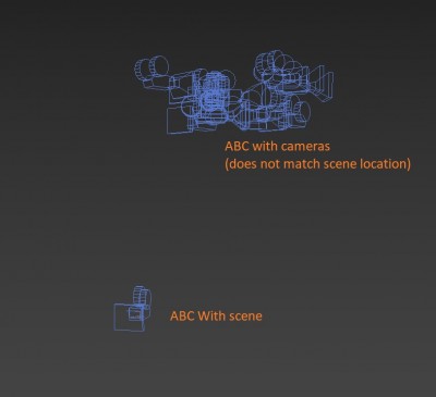

Whatever export settings Octane uses are not the same as 3ds Max's. As you can see in the image below, the cameras don't export the same when I use 3ds MAx versus if I use Octane to export:
viewtopic.php?f=30&t=69972&p=354122&hil ... as#p354122
I figured out that to match, the CAMERAS file has to be rescaled to inches. It can then be used to place cameras by plugging these nodes into Render Targets.
I would prefer if I could just export the cameras as part of the ORBx, less manual work would be required.
I also cannot transform these cameras into 360 cameras. I was wonderring if there is a way to extract the position node only of these cameras so that I can plug them into matching 360 cubemap cameras.
