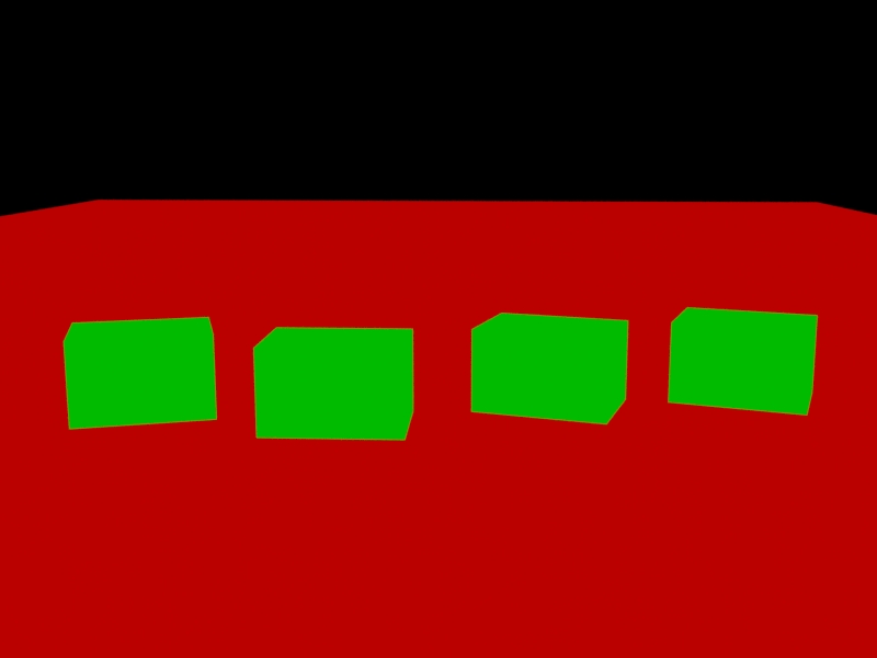

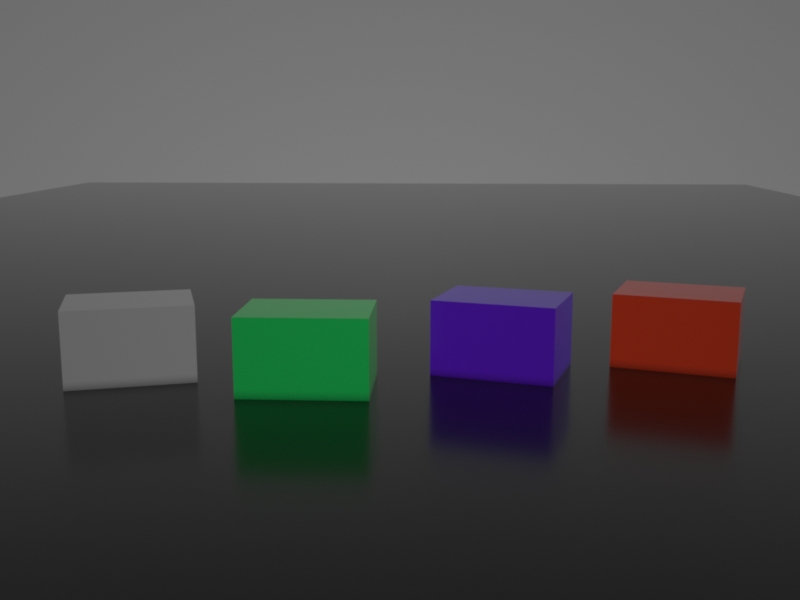

would'nt it be easyer to use Render Layer, and use the "Render Layer Mask" Pass? or the Render Layer ID
Select all Boxes and Rightclick "Octane Properties" set them to Renderlayer 2 or someting..
Beauty
Beauty
Render Layer ID
Render Layer ID

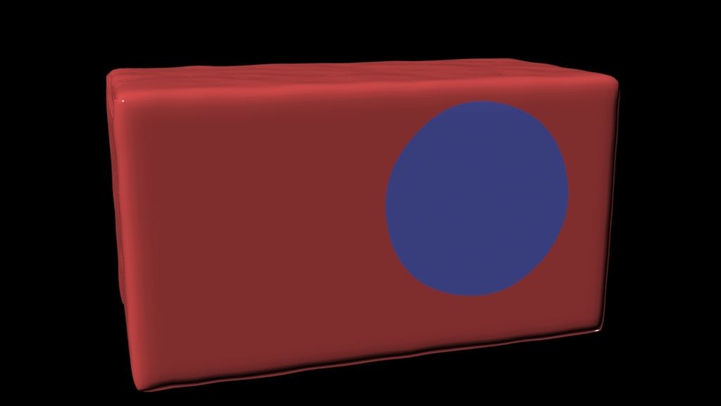

That's what I did, as a workaround for the Object IDs. But my main goal was to have an extra pass from the Material IDs because the material of the boxes have 2 different materials under a Mix Material, a glossy one and a diffuse one.
Beauty (from mental ray)
Material ID (from mental ray)
Octane has the option to render the Material IDs, under Render Elements ---> Info Pass: Material ID.

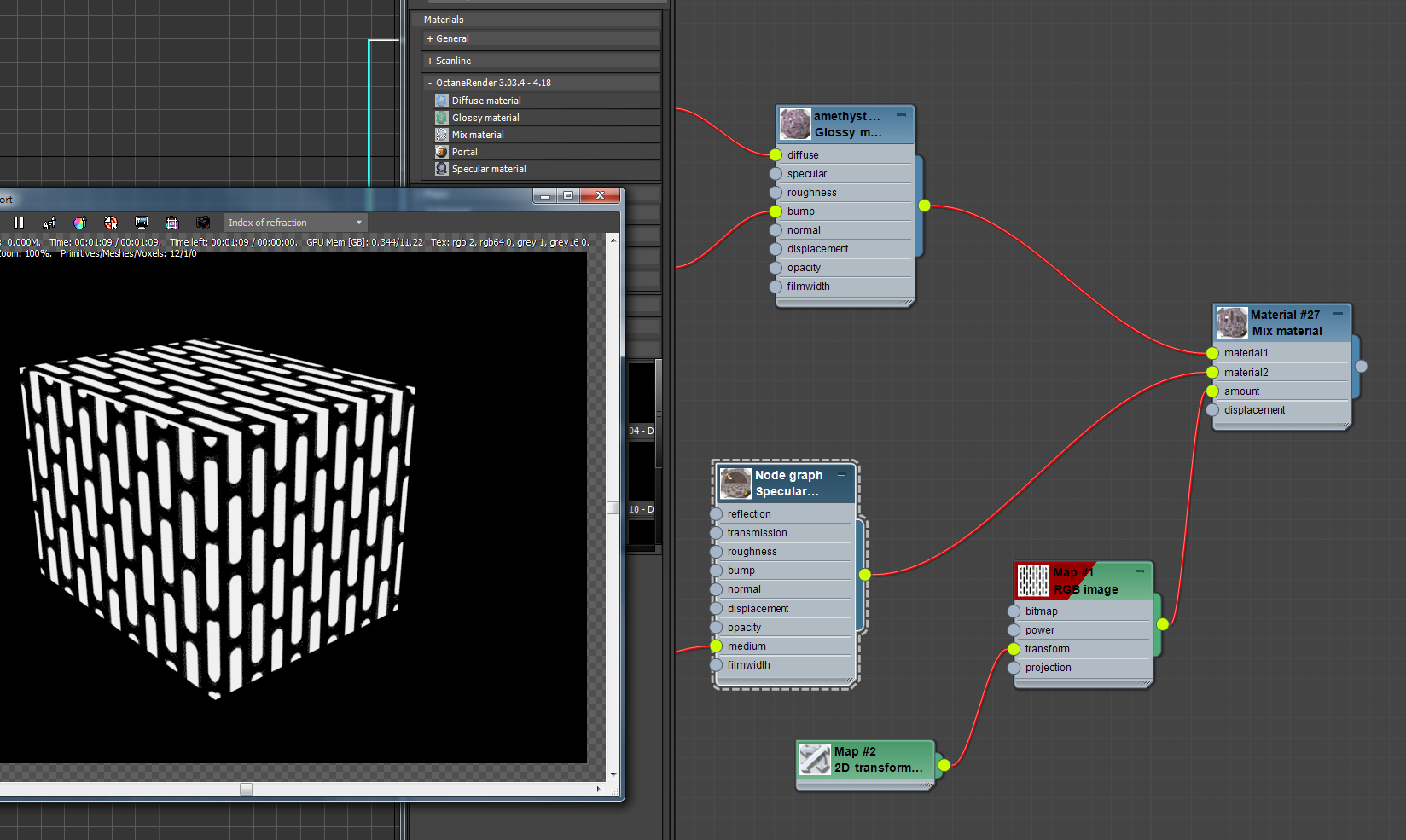

paride4331
Posts: 3964
Hi zoulag3d,
You could solve the issue using the IOR layer.
Using a big difference of IOR between a material and another, you will have a black and white layer more contrasted.
I hope it can help you
Regards
Paride
