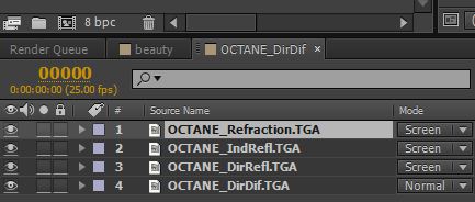

Whats the order we have to give to EACH pass in After effects in order to get the same image rendered?? and what are the modes for each pass??
Im trying but im getting different result, i think im not setting modes and ordering right.
Also Karbe would it be possible to add a Shadow Pass?
Nildo
My Order is this..
Direct Diffuse is the lowest, then i put
Direct Reflection then
Indirect Reflection
and finally Refraction

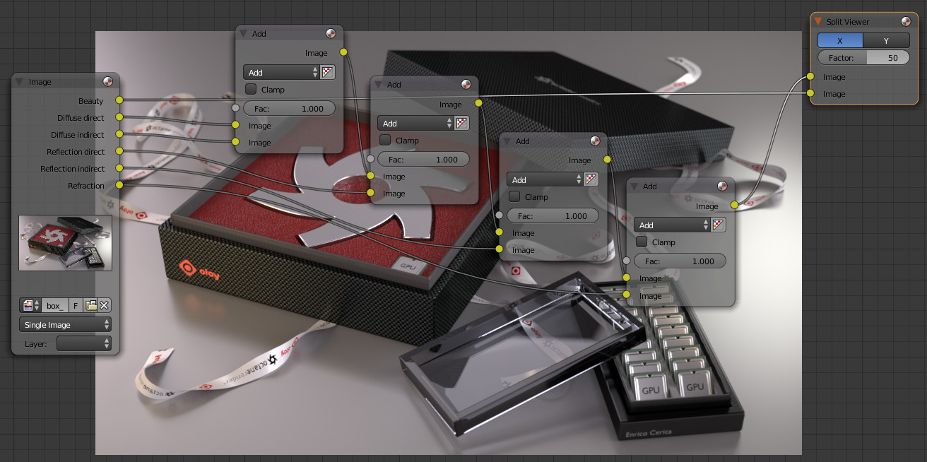

All our render passes add up so a simple addition should suffice -- order should not make any difference. Can you simply add up the layers and see if that works?
Here's a screenshot with a setup from blender that produces exactly the same result as the beauty pass:
