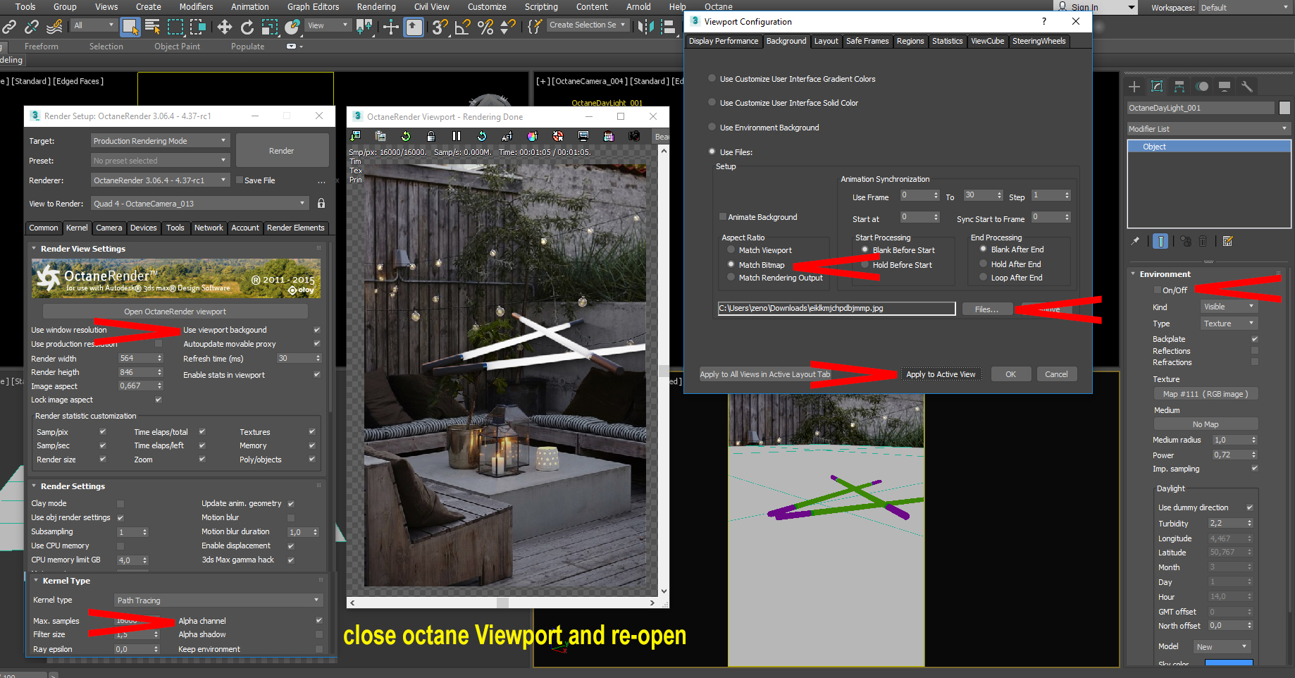

thanks for tip. it was my mistake.HHbomb wrote:you need to check "alpha channel" in kernel type section.
"use viewport background" option doesn't work?

For me i still have a problem as i check "alpha channel" but even if kernel is showing what i want when i save the picture i don't have waht i saw inside the kernel ...

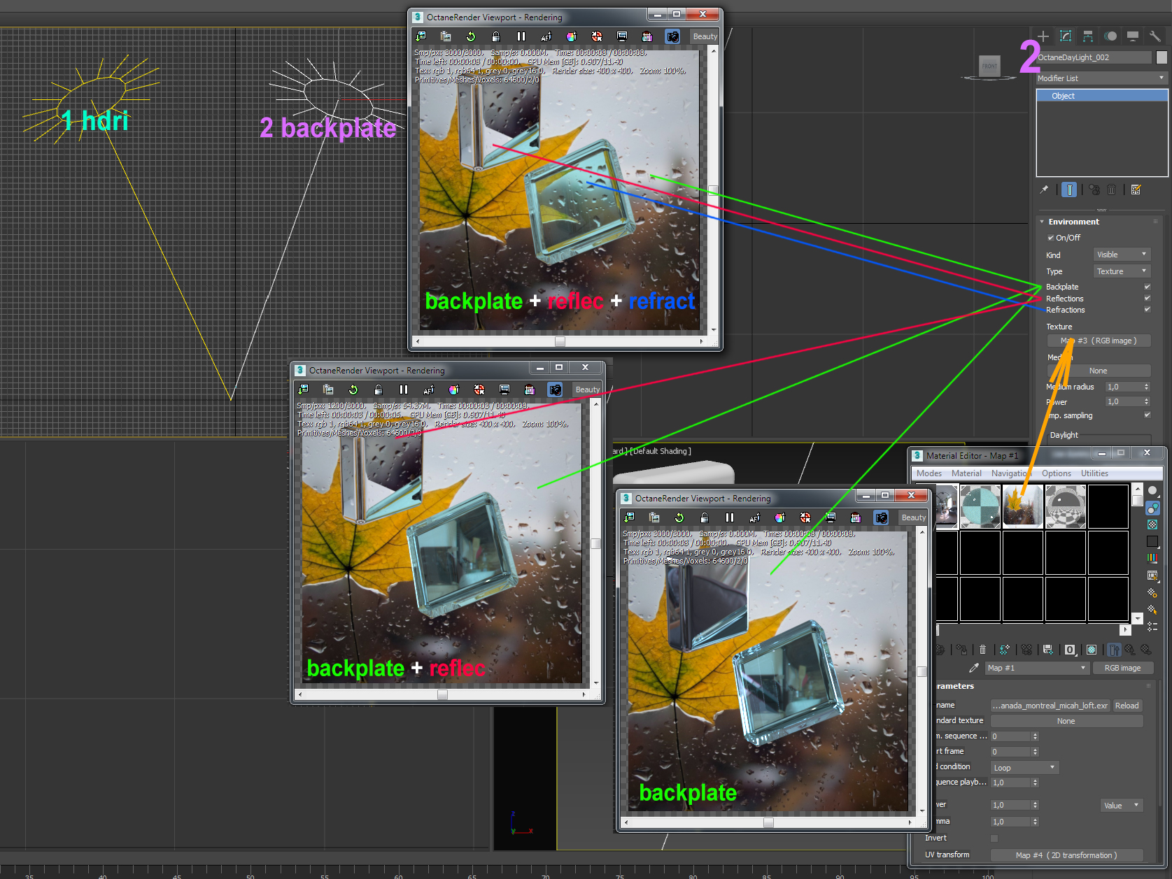

Thanks you so MUCH !!! Paride !!! Don't know if you're a women or a man anyway i love you haha.
So for short maybe it will help people later :
-the solution was to make 2 DayLights one with the HDRI Picture set as main --> texture and the other Daylight with the backplate on it set as visible --> texture with backplate checked.
