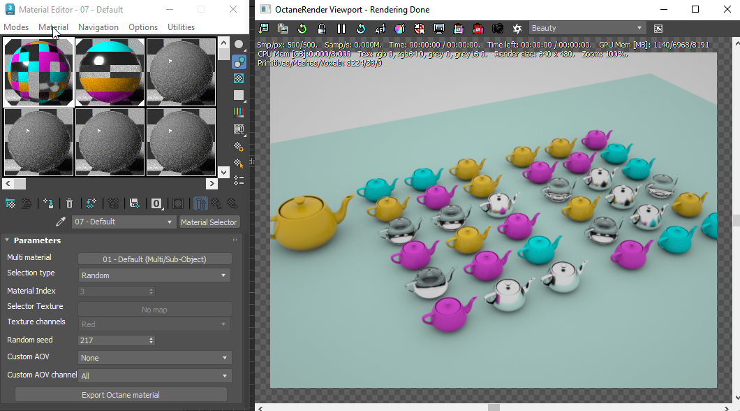

* Additional features
- Random material
Set the Selection type to 'Random'
Use the seed parameter to generate different random distribution.
Internally using an Octane Random Color texture, this generates values that are used to select one of the material.

Here are some samples:
MtlSelector_AnimatedIndex.max :
MtlSelector_Random.max :
MtlSelector_Texture.max :

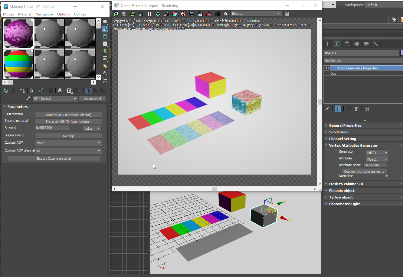

UPDATE (from 13.16) : Addition of the 'Material Index' generator.
To apply materials from a multi material using the Material selector, the Octane Geometry Modifier has options to generate the appropriate vertex attribute.
The use of Material ID ('Mtl ID') as vertex attribute can gives incorrect values.
It is preferable to use the new Generator mode 'Mtl Index'.
The 'Grayscale vertex attribute' texture is used to read values based of the material ID of the mesh
This match the 'Mtl Index' that must be set in the Octane Geometry Modifier, and both are set with the 'MaterialIndex' attribute name.
This creates grey values from dark grey to white, that can be used in various ways, especially as selection method in the 'Material Selector' material.

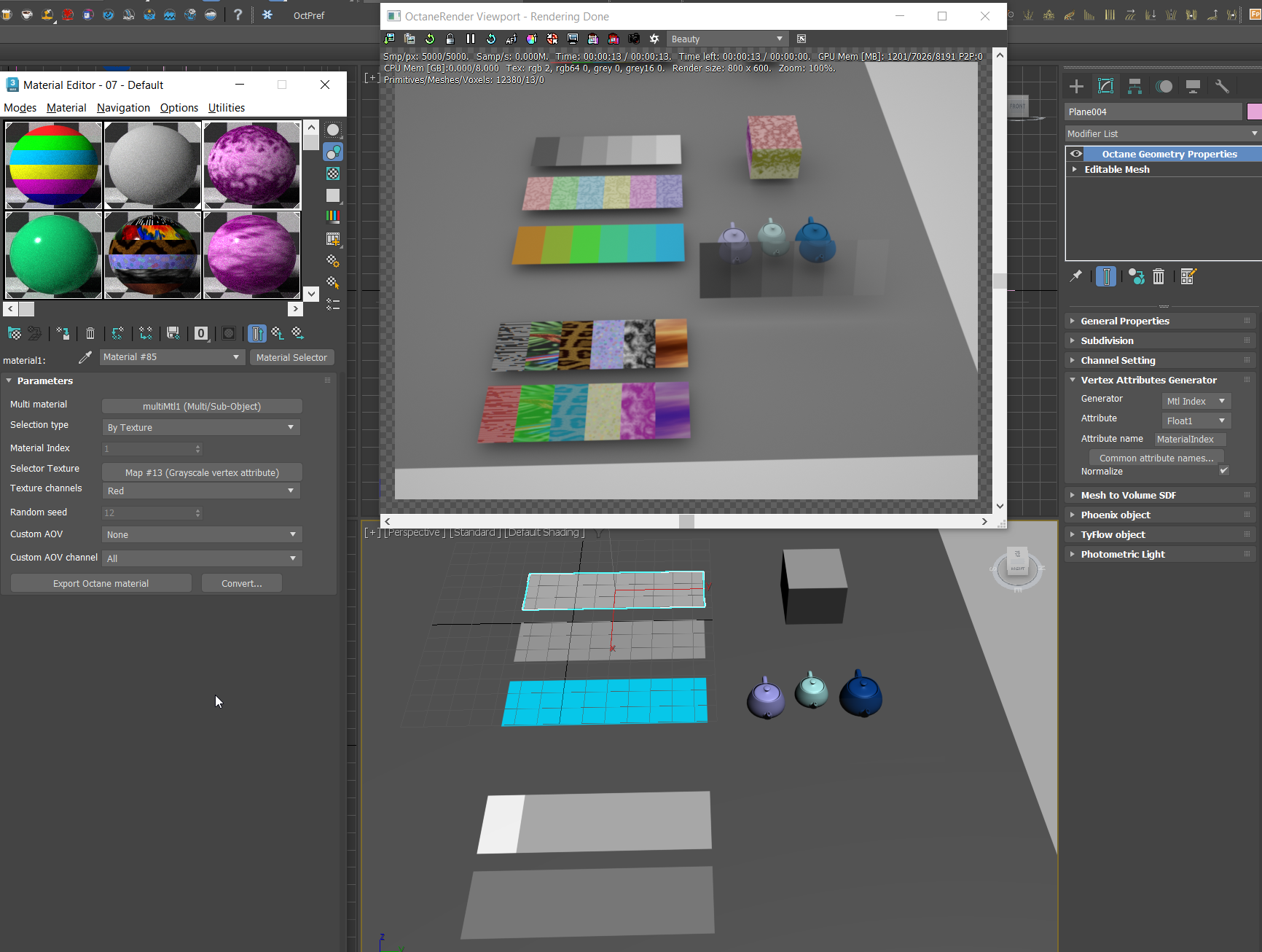

Here are some updated samples: Blended_multiMtl08.max:
Plane materials, as seen from top to bottom:
-Plane002 : a default multi materials with simple colored materials
-Plane004 : the 'Grayscale vertex attribute' set as diffuse texture
-Plane003 : a Mix material with a Material selector and multi material to select 6 colored materials, mixed with a material with a Marble texture
MaterialIndexSamples03.max: Plane materials, as seen from top to bottom:
-Plane006 : a Mix material with a Material selector and multi material to select 6 colored materials, mixed with a material with a Marble texture
-Plane003 : the 'Grayscale vertex attribute' used as input of a Gradient texture
-Plane007 : a Specular material with the 'Grayscale vertex attribute' used as Transmission
-Plane009 : a default multi materials with 6 textured materials
-Plane010 : a Mix materials mixing 2 Material selectors

Another sample to illustrate the use of the Material Selector as an Octane interface to the 3dsmax Multi material.
For example, the Octane Mix material takes 2 Octane materials as input.
Using a Multi material as one of the input is not directly possible, as it's not an Octane material.
We can achieve the same thing by using a Material Selector instead.
The Material Selector will contain the Multi material, and will use the material index of the object to display the corresponding mixed material.
