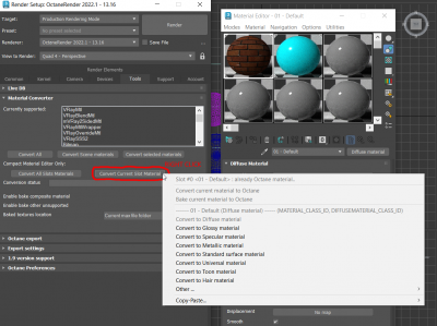

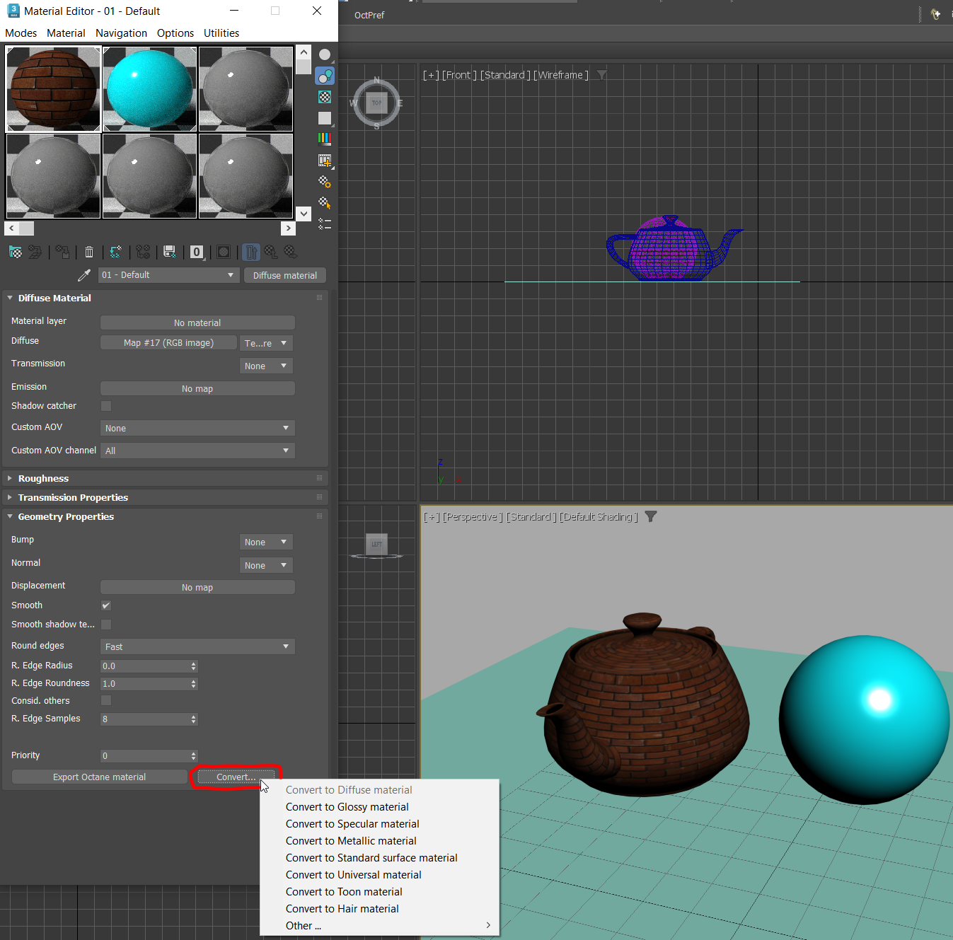

The conversion options are available on the 'Convert...' button in each material dialog.
This is also available in the context menu of the 'Convert Current Slot Material' button, in Tools / Material Converter of the render settings dialog.

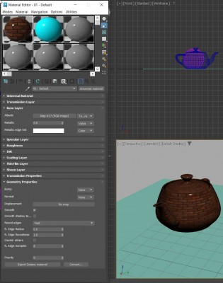

Here is a sample scene to try those features:
-Open MtlTypeConvert01.max
-Open the Material Editor in Compact mode
-Select the first material :01 - Default (a Diffuse material)
-Left Click on 'Convert..." button, select 'Convert to Universal Material'
01 - Default is now a Universal material, with parameters set from the previous Diffuse material.
The teapot material has been changed to the new material.

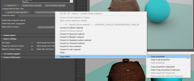

Those copy/paste options are available :
-For Octane materials, in the Context menu of the 'Convert...' button (Right click, instead of Left click)
-In the context menu of the 'Convert Current Slot Material' button, in Tools / Material Converter of the render settings dialog.
-In the context menu of the 'Convert All Slot Materials' button, for operations on all the Sample Slots (Compact mode)

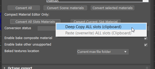

To copy all slots:
-In Max2022, open the Material editor (Compact mode)
-In Render Settings, Tools / 'Convert All Slot Materials' context menu, choose 'Deep Copy ALL slots (clipboard)'
-In Max2023, open the Material editor (Compact mode)
-In Render Settings, Tools / 'Convert All Slot Materials' context menu, choose 'Paste (Overwrite) ALL Slots (clipboard)'

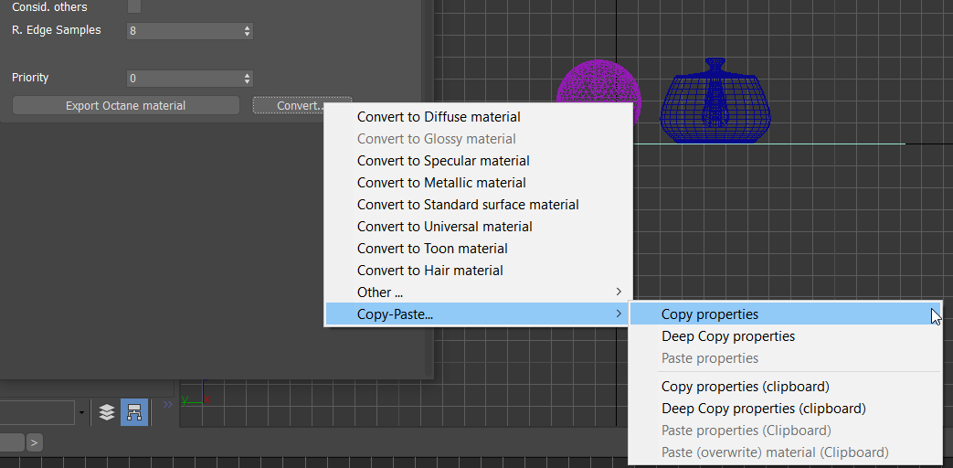

'Copy properties': Copy properties of current selected slot material or texture.
When using a Paste operation, the sub materials and textures will be references.
'Deep copy properties': Copy properties of current material, and all it's sub materials and textures.
When using a Paste operation, the sub materials and textures will be duplicates.
'Paste properties' : copy all properties of currently copied material to selected slot.
Overwrite current material properties with the properties previousely copied.
If 'Deep copy' was used, the sub materials and textures will be duplicates.
'Paste (overwrite) properties: Discard material in current slot
This re-create a new material in the current slot.
