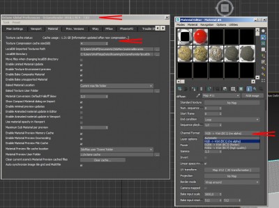

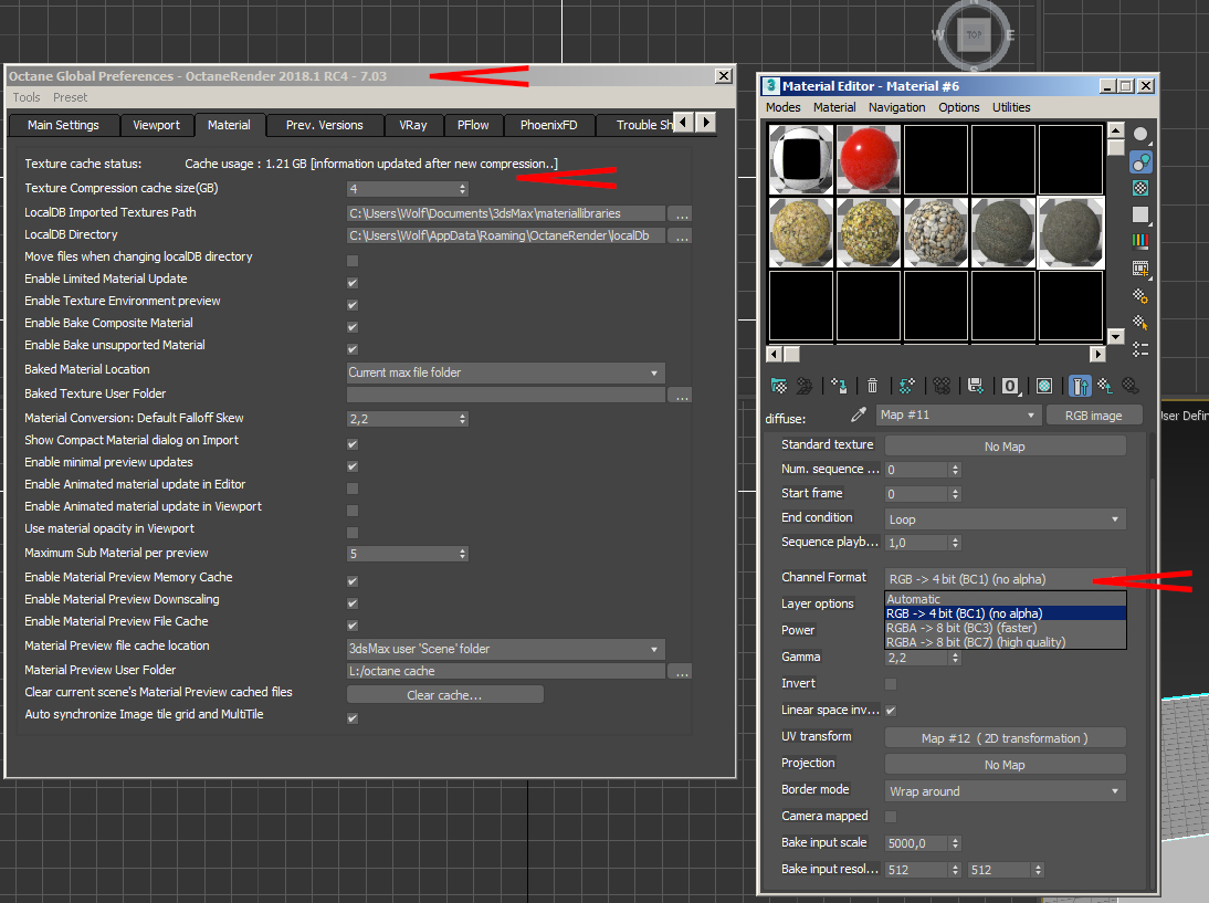

Hi senorpablo,
Octane for 3dsMAx 4.0x save textures compression on the fly, new 2018.x makes available texture compression cache on disk, settable in global preferences.
Regards
Paride

Hi senorpablo,
V4 > compress on the fly ( every time)
V2018.x > texture compression cache on disk
Regards
