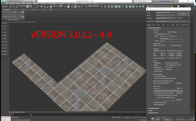

VERSION 3.03.2 - 4.9 it was completely fine. See attached.

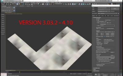

VERSION 3.03.2 - 4.10 it was suddenly broken. See attached.
Both of these screenshots have IDENTICAL settings. Nothing changed. The texture map is applied with a 12 x 12 "REAL WORLD MAP SIZE"
There must be something subtle in the code you guys changed that broke the VIEWPORT textures preview system. Please try to dial into this new information. It took hours to figure out exactly when it got broken.

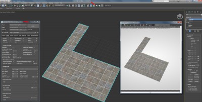

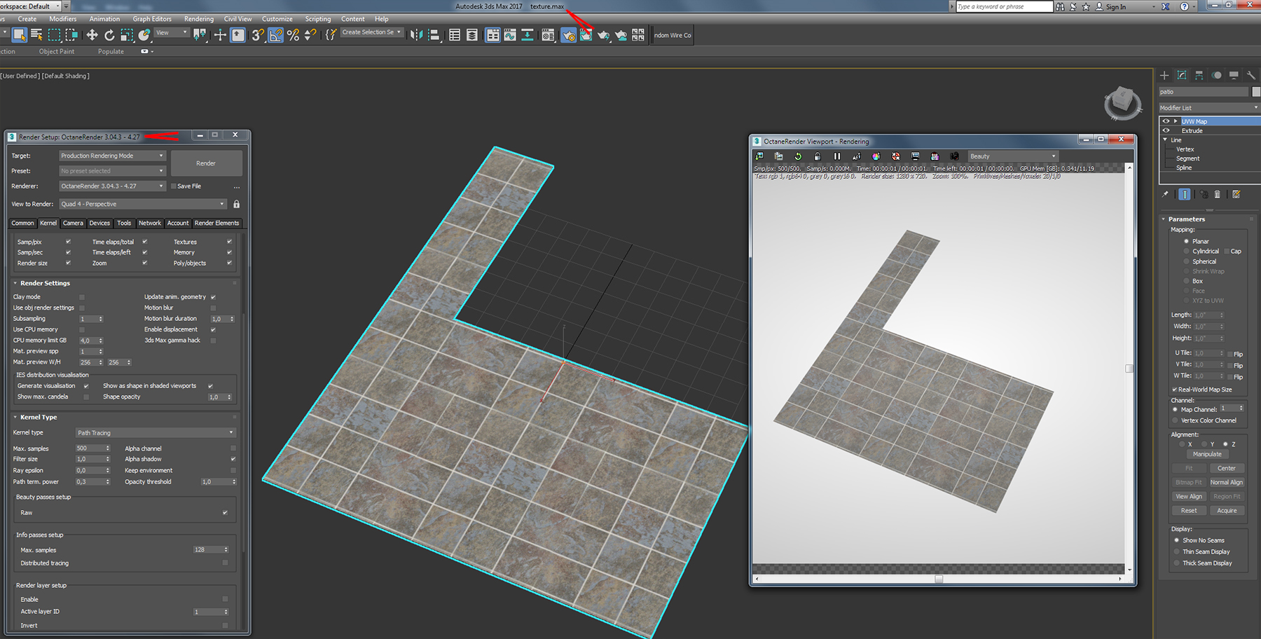

Hi richardyarlett,
Issue you report is fixed in the next 4.27
a screenshot attached
Kind Regards
Gabriele
