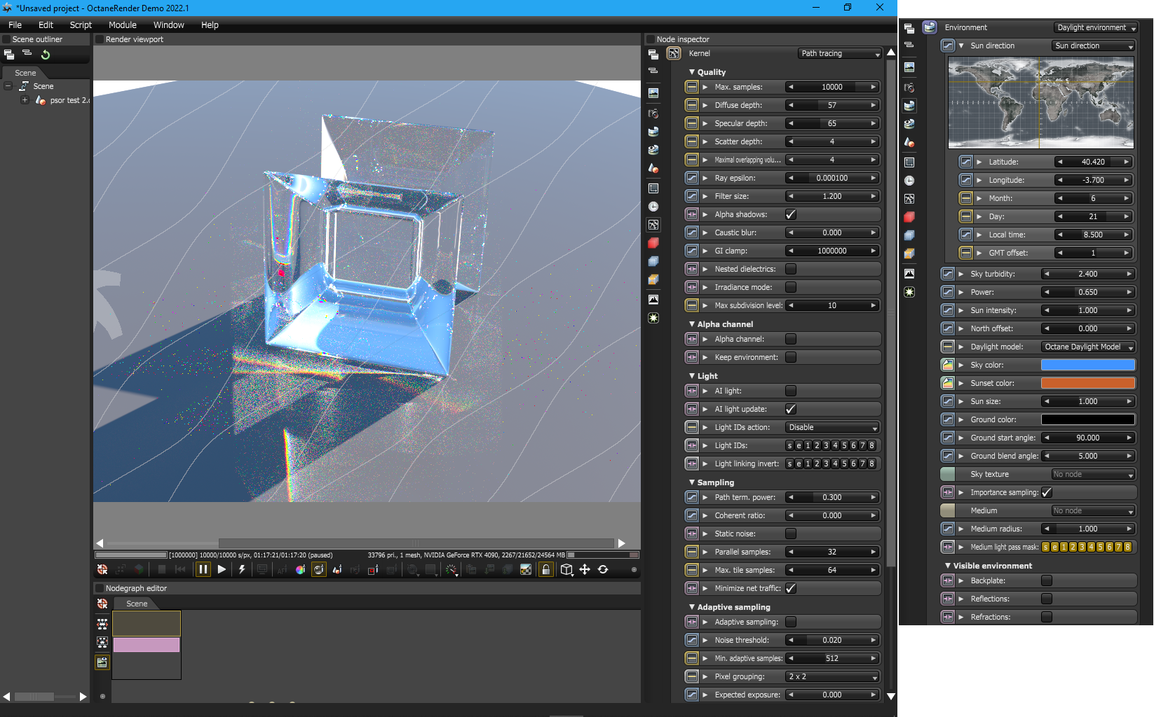

Difference between my 2 images rendered about variable caustics at 0.09 (9%) roughness of ground:
- At Path Tracing (PT) kernel - I apologize for noises but I needed very, very long number of samples per pixel

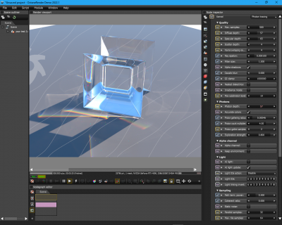

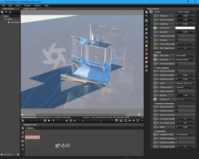

- At new Photon Tracing with denoiser - quick direct+indirect caustics = only 20 seconds on my RTX 4090 but unfortunately, this is not any variable caustics visible at less than 0.3~0.4 (30%~40%) roughness of ground
-> But this new kernel seems to be NORMAL. ;)

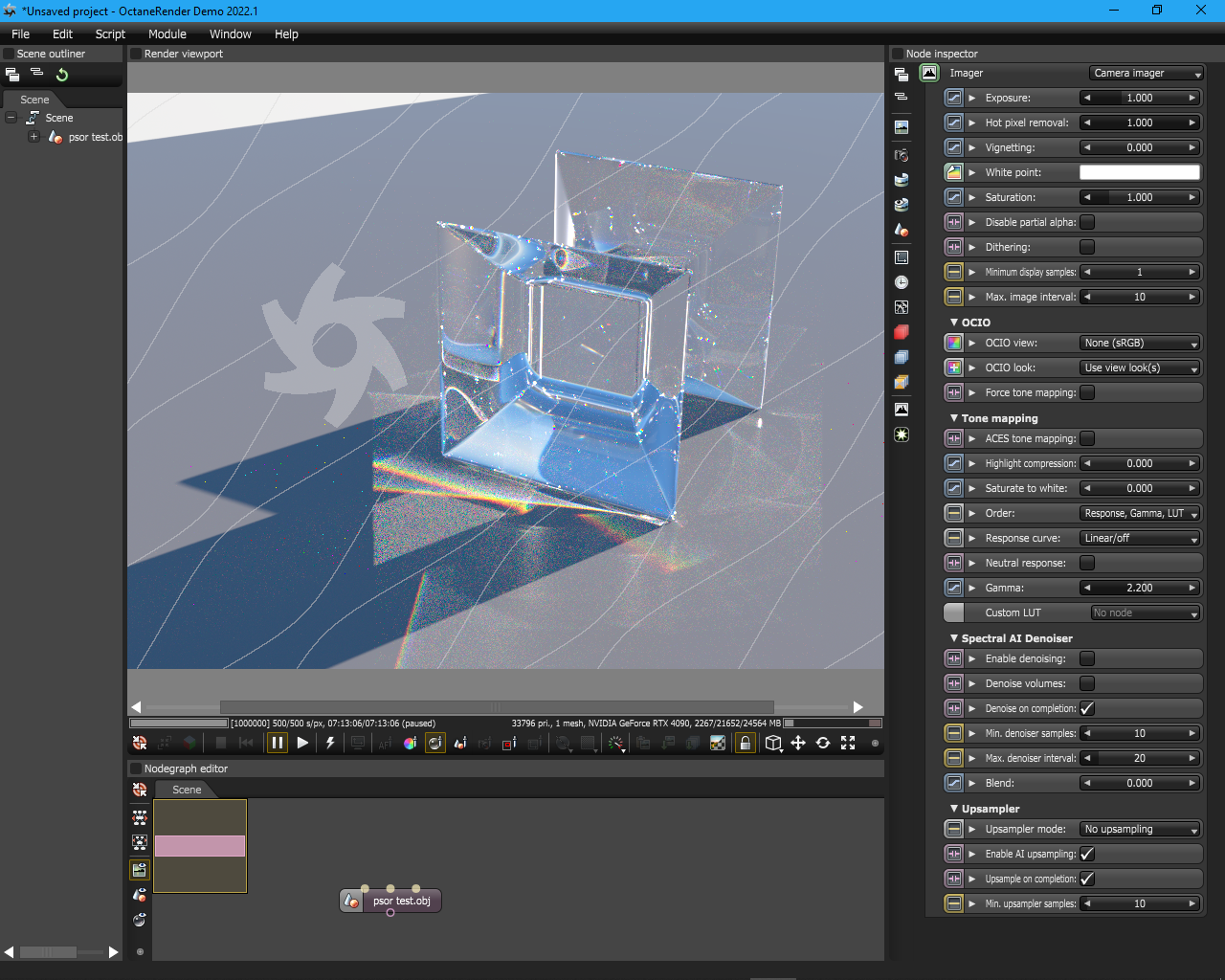

Sorry for later.
rough 0.09_PT-2_total 2h50min render time - total 2M-spp_7 regions picked of 1M-spp.PNG
See the difference between 2 images (this new and 1st) about caustics "animated" while the camera is moved due to the variable caustics. :)

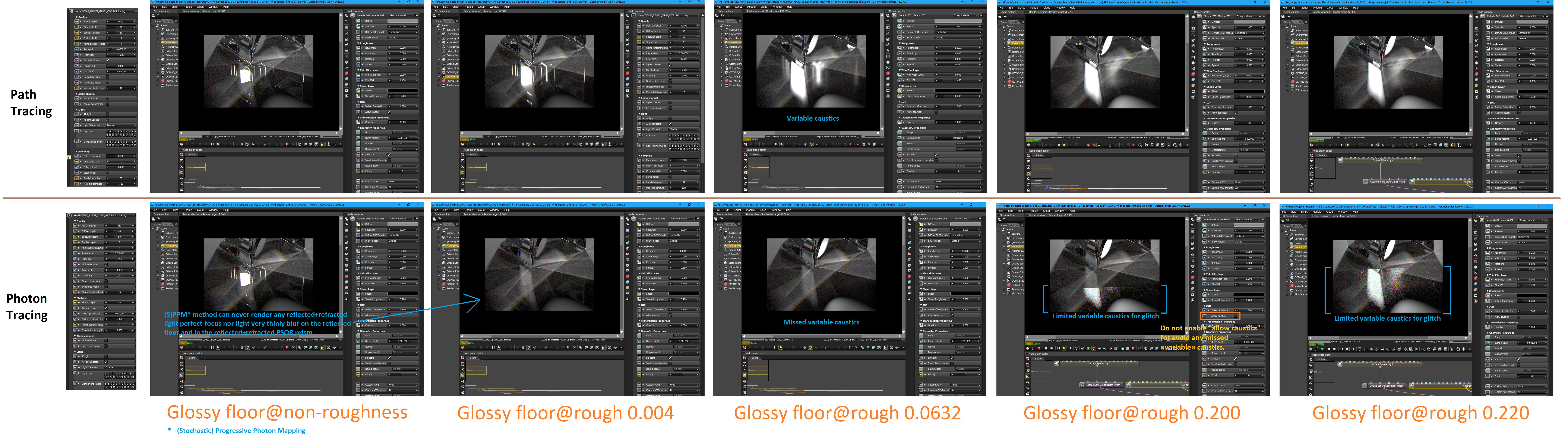

New rendered images:
This is easier and better understand about the variable caustics. :)
--> Download - ORBX project <--: Don't forget to change kernel to Photon Tracing (PHT) - check new image above about PHT settings. ;)

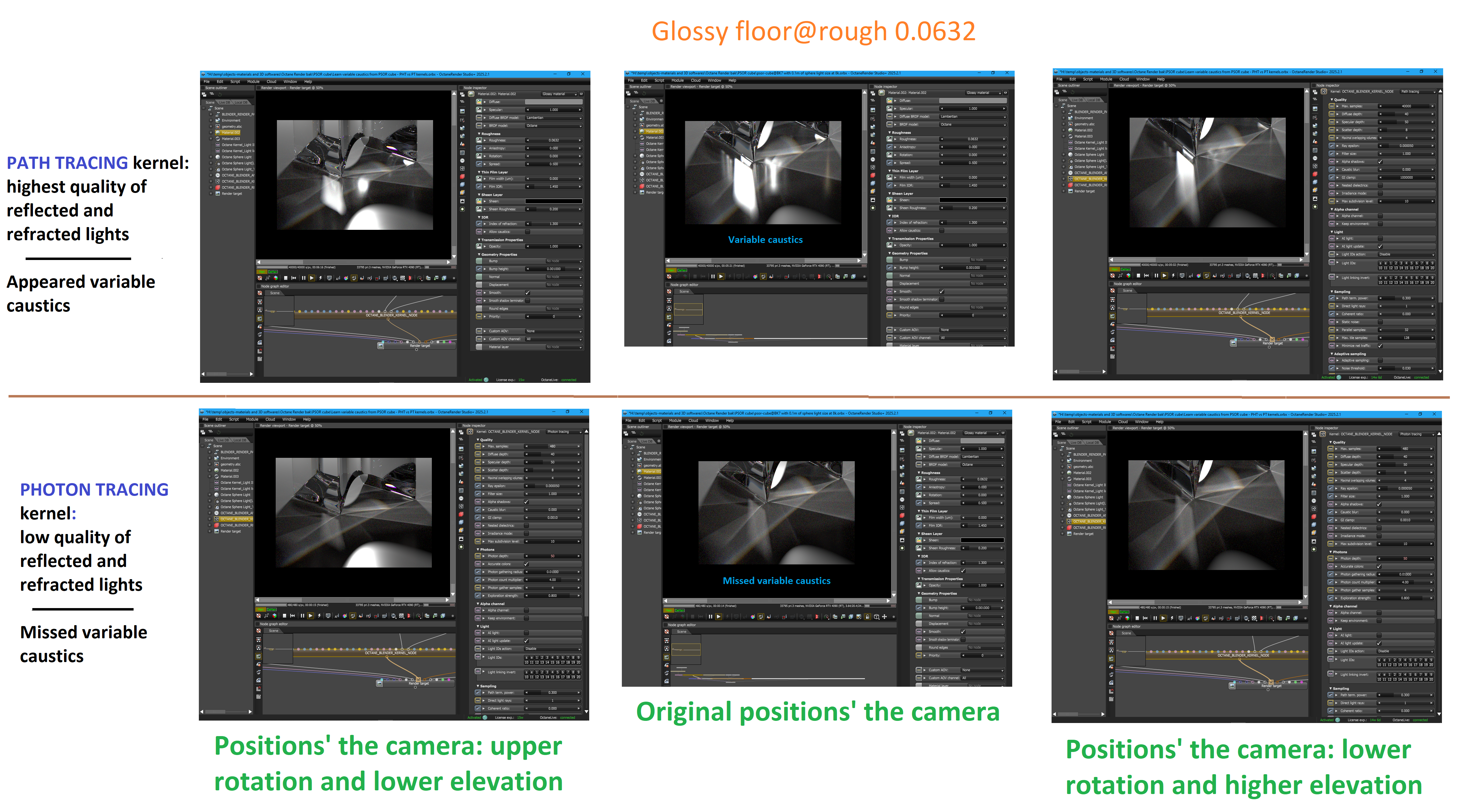

--When the camera is moving--:
-On Photon Tracing, caustics aren't changing due to MISSED "variable" caustics;
-On Path Tracing, caustics are changing despite fixed light source.
Happy Rendering and best regards! :mrgreen: ;)
