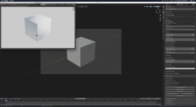

Hey there,
I just downloaded all files and followed a tutorial on how to start with Octane in Blender. For some reason though I cannot open the "Device Preferences" in the Octane Render render settings and the rendering is stuck on "Waiting for image". I changed the environment to Texture Environment and applied an HDRI. Anyone know about this issue or am I missing something here? Thanks for your help...

at the moment you can’t out of the box.
You need another PC equipped with Nvidia GPUs:
viewtopic.php?f=24&t=45208#p242913
Blender Octane 2020 on Catalina, with RTX GPUs on PC
or you need to go back to High Sierra, and use an eGPU box via Thunderbolt 3, I personally work everyday with an iMac 27" 5k 2017 with Thunderbolt 3 eGPU 2x 1070, under High Sierra.
Note that it is necessary to install a custom script, and some precautions, so let me know if you are interested in this solution.

you still need High Sierra 10.13.6 + CUDA 410.130 + Nvidia GPU to be able to use Octane on Mac.
ciao Beppe
