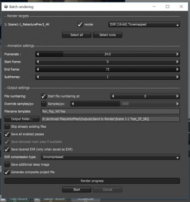

I did batch rendering already and it did not look like the picture from the documentation in your link. I checked the save all enabled passes but when I finished rendering it only rendered the beauty pass. I am running Octane 2019 Stand alone. I attached here a pic of what the batch rendering module looks like on my end and the settings I used. Thanks for your help!
weird, it seems to work as expected in 2019.1.5 here:
ciao Beppe
